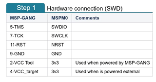

Hi Expert,
The customer tries to use MSP-GANG to burn the image to MSPM0L1105 of the customized board, but "ERROR 23" will be displayed.
I changed ports 1, 3, and 4 of MSP-GANG but the same error message appears.
Customers can program successfully using XDS110
flash tool Pin define refer to the picture below.
The question looks similar to the discussion below
https://e2e.ti.com/support/microcontrollers/arm-based-microcontrollers-group/arm-based-microcontrollers/f/arm-based-microcontrollers-forum/1247574/mspm0l1305-msp-gang-programmer-error
Do you have any normal use cases or related information?
How to solve the problems that customers are encountering now?
