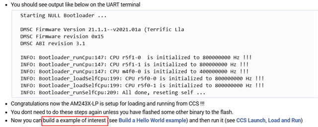

    Customer switched the bootmode to OSPI boot on this EVM board, and they could see the log below.
    And according to the guide below, we could now the EVM has been flashed before, but the strange point is that it could not be erased.
    And the error log shows that it stuck when executing sbl_null.release.hs_fs.tiimage, may I know would that because previously customer flashed an "incorrect" sbl_null.release.hs_fs.tiimage causing this problem and is there any other way to reflash this image?
