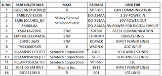

    Are you sure these diodes, TVS are rated for your ESD voltages ( (+/- 6kV contact and +/-8kV discharge) ?

    PFB the list of ESD components added in our design based on the type of IO / Function

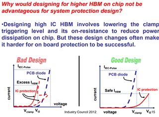

  • Talking to our expert, he basically says that ISO 10605 are system level tests at an "ECU level" and if you expose our devices directly to these levels you will potentailly blow up our devices. It is customers responsibility to design protection and not pass such voltages to our devices.  Also note that ESD studies on components are NOT run on power on conditions. If customer is doing such ESD tests and seeing latchup, it is outside of our controls. Lastly, TM4C123 is not an automotive rated device. This below document will be useful to understand more about component and system level ESD testing.
    Industry Council_System Level ESD_March2012.pdf
    Here is an app note about ISO10605 https://www.ti.com/lit/an/slva954b/slva954b.pdf

      I hope you had a chance to read through the document I provided. I don't know if your rest of components are capable to withstanding the rated test. You will need to go through that yourself. One of the slides talks about the TVS diode that needs to be able to protect and clamp within the MCU's HBM limit.
