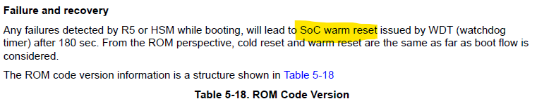

    There is no HW to reset QSPI Flash in customer board. I meant if below SoC warm reset from RBL can be implemented in MCAL MCU reset module.
    From TRM, I found RBL will issue SoC warm reset when fail to load SBL during 3min as below.

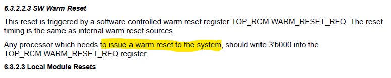

    I also find system warm reset in below TRM. I would like to know if there is a way to implement below system warm reset in MCAL MCU module.

  • Hi Gunjan,
    Thanks for your response.
    with your suggestion of ".Mcu_ResetMode = MCU_PERFORM_RESET_MODE_WARM,", customer experienced only CPU warm reset was issued, but they are looking for the way how they can issue "SoC warm reset".
    Thanks and Best Regards,
    SI.
  • Hello SI,
    I have tested reset on am263x using Mcu_PerformReset  and ".Mcu_ResetMode = MCU_PERFORM_RESET_MODE_WARM,".
    It does warm resets and QSPI bootloader starts and flashed application image is loaded and application run successfully.
    All peripherals having Warm Reset Sources as input to their 'warmreset' logic will get reset (QSPI0 in AM263x TRM).
