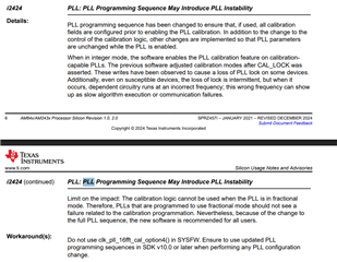

Hi TI Experts,
In the latest SDK9.2 release note, we see there are 2 important fix for PLL sequence shown below.
https://software-dl.ti.com/processor-industrial-sw/esd/ind_comms_sdk/am243x/09_02_00_24/mcu_plus_sdk/docs/api_guide_am243x/RELEASE_NOTES_09_02_00_PAGE.html
Fix 1:
Fix 2:
Actually customer already used SDK9.1 for mass production. Customer wants to know the impact for the above two PLL issue if they still use SDK9.1 Is this issue the same as the errata below?
Customer hopes to know if they could have a patch for the above two fix on SDK9.1 so that they do not need entirely upgrade to SDK9.2 to only have the PLL fix.
