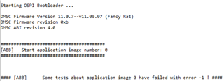

We noticed two types of crashes.
In the first case of crash it seems that the sbl ospi fails to authenticate the image, in particular it fails in: Bootloader_parseMultiCoreAppImage -> Bootloader_verifyMulticoreImage -> Bootloader_socAuthImage -> Sciclient_procBootAuthAndStart, where the check if((retVal != SystemP_SUCCESS) ||  ((respParam.flags & TISCI_MSG_FLAG_ACK) != TISCI_MSG_FLAG_ACK)) is true because of the respParam.flags part (while retVal == SystemP_SUCCESS).
In the second case of crash instead the error seems more at the configuration level because sbl_ospi tries to enable PHY but fails:

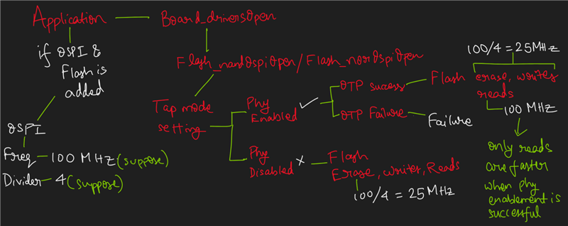

    Let me explain this with the help of diagram in a separate response.
    Should the algorithm be done in the high temperature conditions where the error occurs? And then is it valid for every condition? Should it be done everytime at startup or only once? I read that I need to write a pattern with --operation=flash-phy-tuning-data, but this option is in a cfg file that I should use in UART mode, but with our custom board we can't go in UART mode, is there any other way?
    Phy enabling can be done at any temperature, by looking at the flow diagram you will understand what phy enabling does/has benefits of it.

  • FYI, here is the flow diagram which will help you understand in an easier way.

    The OTP values is indeed saved to a local variable but also to the registers.
    Please refer this API: OSPI_phySetRdDelayTxRxDLL
    After OTP is computed, the above API is called and it stores the OTP value in the registers. This flow can be found in OSPI_phyTuneDDR function itself.
    Hope this clarifies your doubt.
    However, it can be used only for read operations, while write and erase operations will still go at the frequency with divider in any case;
    When Phy enabling is a success, Read happens at 166
    When Phy enabling is not a success or Phy mode is disabled, Read happens at 166/8
    In either of the cases, writes and erase will happen at 166/8.

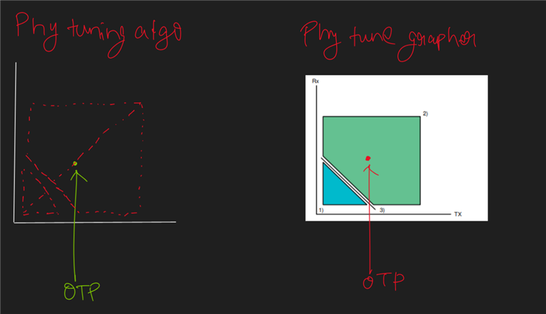

    It is also possible to compute this data explicitly with the OSPI_phyTuneGrapher function (as I see here), I can try to run this and compare the values and I expect to find similar values;
    Please understand this with the help of the following illustration:
    The algorithm looks at the minimal number of points to come to a conclusion about what could be the OTP point.
    The grapher on the other hand, plots the entire graph, hence, this can be used to pick the OTP as well. The issue here is that, it takes a lot of time compared to the Phy tuning algo. As here we sweep across every combination: (4 * 128 * 128).
    NOTE: The graph on the left hand side is the same as the one on the right, the red dots denote the points traversed to come to a conclusion of finding the OTP.
