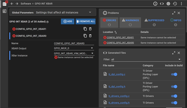

  1. I am trying to trigger input interrupts for 12 GPIOs. 2 of them are MUX interrupts, while the other 10 are distributed across 6 banks. Therefore, I would need 8 interrupt condition instances. Can multiple instances use the same interrupt condition, because I’ve been getting errors what I try to do that.

  • If two separate XBARs are set to the same instance, I got the following error (in this case I tried give them both an instance of GPIO_INT_XBAR_VIM_MODULE0_1).
  • Thank you for the information! The links say that only 4 XBars can be routed to VIM_0. However, I have to create 6 bank interrupts + 2 individual interrupts. So I am wondering if it is possible to do more than 4 interrupts. Even in the second link, they ended up doing 1 bank interrupt + 3 individual interrupts. Do you have any examples on how to do more than 4? Here's the breakdown of the interrupts that I need if that helps.

    We are using up to 6 banks, so this makes us think we can only use GPIO_INT_XBAR_VIM_MODULE0_0 to GPIO_INT_XBAR_VIM_MODULE0_3. Our impression is that we cannot use GPIO_INT_XBAR_VIM_MODULE1_x to GPIO_INT_XBAR_VIM_MODULE3_x because we are not loading this program to core 1 to 3. Please correct us if our understanding is incorrect.
    Your understanding is correct, as can be seen from the TRM.
    An alternative is putting multiple banks on 1 VIM instance. Is this possible? Sysconfig only gives us the ability to choose 1 xbar output per xbar instance.
    No, as can be seen from the TRM again, each output can only be sourced from a single input. Assigning a second gpio source to an already-used VIM is not possible as it would overwrite the first.

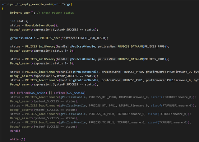

    The approach to do this should be something like the following (We'll loop in the PRU expert to confirm this):
    • Route 4 Critical Interrupts Directly
    • Route the remaining interrupts to PRU using GPIO_INT_XBAR_ICSS_XBAR
    • Program the PRU to get the event from GPIO, and then trigger a new event back to the R5F VIM, PRU has 16 dedicated event outputs for this purpose
    • Create One R5F ISR for the PRU
    To get started on this you can look at the PRU-IO example provided in the SDK.

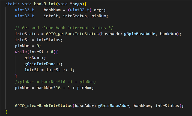

    1.
    In this code for creating a bank interrupt using a VIM Module, is there a way to determine which of the pins caused the bank interrupt?
    2. In the same above screenshot, why does gGpioBaseAddr not change depending on what bank we are trying to create the interrupt for? And how do I choose the correct gGpioBaseAddr?
    3.
    You said in the previous message to reference the PRU-IO example. Is the code I should be referencing? If so, I still don't really understand how to trigger a new event back to the R5F VIM? And how do I create a R5F ISR for the PRU, and how do I initialize the pins that I want to create interrupts for to the PRU?
