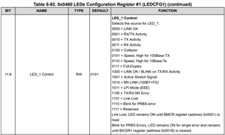

  • Hi Wei,
    Looks like the LED1 is configured to 0x1C00 value during this scenario, that is LED1 Control : TX/RX MII Error:
    Coming to the BMCR Register, it also has value 0x1C00, which implies the following bits are set:
    Looks like the PHy is going to a power down state. Are you re-configuring LED1 somewhere within the application. Additionally, can you monitor the following ESC Registers to check if the Firmware is receiving any RX error frames or link drops:
    Aaron

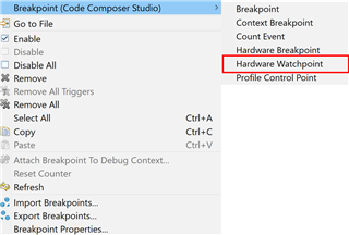

    3. The PHY configuration is done using MDIO_USER_ACCESS_REG of the MDIO module. One thing you can do is add a Hardware Watchpoint at the MDIO_USER_ACCESS_REG offset, that is, 0x30090E40 + 0x80 if you're using MDIO Firmware Workaround (MDIO_MANUAL_MODE_ENABLED) or 0x300B2480 if you're not using the MDIO firmware emulation. With this, we should see who is writing to MDIO_USER_ACCESS_REG during the ongoing EtherCAT communication. To add a HW Watchpoint, you can do the following:
      • Once you have loaded the application on the R5F core, open Breakpoints from View --> Breakpoints
      • Right click on the Breakpoints Window and choose Breakpoint -> Hardware Watchpoint.
      • In the Hardware Watchpoint Box, enter the address in "Location field" and choose Write in the "Memory" field,
      • After "OK", you can verify in the Breakpoints Window if the required Breakpoint is enabled.
      • You can add this once the initial PHY register configurations are complete.

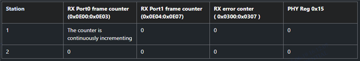

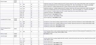

    • I would like to stress on this point once again as when RX_ERR threshold is detected, the link partner is informed by restarting the Auto-Negotiation mechanism via the MII Management Interface.
    • You can monitor the ESC register space from 0x0300 to 0x0307 for the RX Error frames detected within the PRU firmware and also from the PHY Register (offset 0x15):
    Aaron
  • Hi Aaron,
    1. Setting bspInitParams->enhancedlink_enable to TIESC_MDIO_RX_LINK_DISABLE results in failure to establish communication with the Master.
    2. After the issue is reproduced, the following statuses are monitored at runtime.
    3. Using a Hardware Watchpoint, we confirmed that no other functions are accessing the PHY registers.
    Could you please help confirm this?
    BR, Wei
  • Okay so 0xE00 aligns to previous finding that only Port0 of Station 1 is identified and port1 of Station 2 remains closed, thereby not detecting any other Stations in the daisy chain.
    Can you also make sure all the required hardware connections mentioned in Hardware Requirements are present in your device.
    Aaron

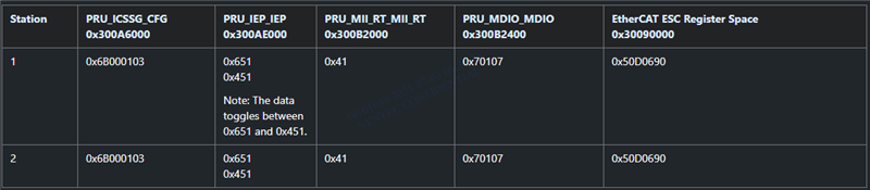

  • Hi Aaron,
    The following is the result of the ICSSG memory dump.
     Information read at runtime during issue reproduction:
    The ICSSG memory data is the same during normal communication and when the issue is reproduced.
    BR, Wei
    • Sorry for the miscommunication. What I was referring was to the complete memory space under the following ICSS modules:
      • PRU_ICSSG_CFG Registers (0x300A6000 to 0x300A6194)
      • PRU_MII_RT_MII_RT Registers (0x300B2000 to 0x300B206C)
      • PRU_MDIO_MDIO Registers (0x300B2400 to 0x300B248C)
      • EtherCAT ESC Registers (0x30090000 to 0x30090ED0)
    Aaron

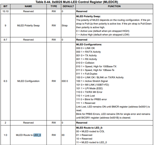

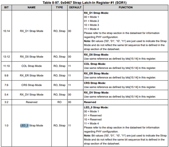

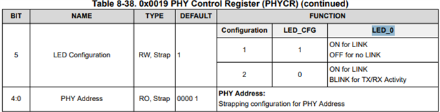

  • Hi Wei,
    On reviewing the ICSS MDIO Registers, I needed to confirm couple of Enhanced Link configurations:
    • The PHY Address of ECAT IN port is 2 and PHY Address of ECAT OUT port is 3. This is aligned in the Syscfg ?
    • I believe the link polarity is configured to ACTIVE_LOW.
    Can you also provide the complete PHY Register dump. Needed to check on couple of LED_0 configurations such as LEDCR (0x0018), PHYCR (0x0019), MLEDCR(0x0025), SOR1(0x0467):
    This is to confirm the LED configurations required for Enhanced Link on Station1.
