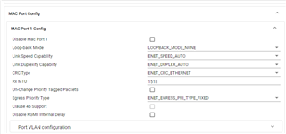

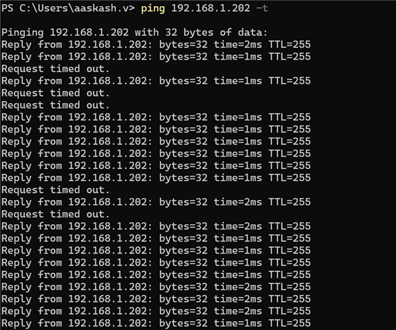

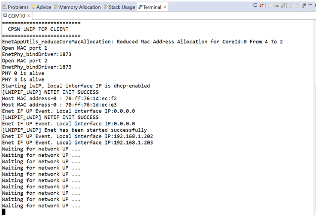

  • Hi Evan,

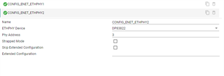

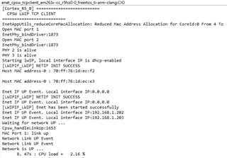

    Thank you for your support!!!!.... As u mentioned the above resistor we tried in our customized board, we are getting 50Mhz ref-clock
    we imported the example code enet_cpsw_tcpclient rtos project to ping 2ip's in 2 different port and i tested in the eval board it was working with DP83826 ic.
    we are getting the debug log as 2 and 3 alive
    so according to that i configured in sysconfig as phy 2 address as 2 and 3.
    mac port configuration manually,
      in auto assign we couldn't able to ping the any ip's
    the below is the static ip i allocated and i tried to ping
    so, in that case i could be able to ping the ip 192.168.1.202 but not 192.168.1.203.
    can you expalin why the phy 2 and phy 3 is alive can you give justification? or it is ok?
  • Hi Akash,
    I'm not clear if "PHY<x> is alive" corresponds to PHY strapped at <x> address - checking with AM2x team to confirm.
    Assuming MAC is able to identify MDIO bus of both PHYs, then ping failure for 202 subnet is likely sysconfig RMII configuration issue.

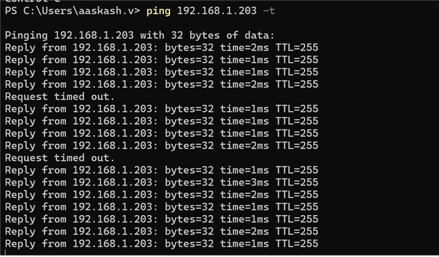

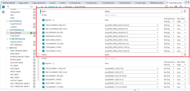

  • Hi Evan,
    sorry for late replay, i just use the same resistor value which you suggested in another customized board and at that time we are able to get the phy 0 and phy 3 as alive.
    and we are using the example code as enet_cpsw_tcpclient.
    so i just configured in sysconfig phy -  0 and 3 and now the ethenet ping happening so here we observed 2 things
    1. if I configure the RMII2 In the 1st instance we can able to ping the 1st IP
    2. if I configure the RMII2 In the 2nd instance we can able to ping the 2nd IP
    can you say why this scenario is happening?
    i am attaching my example.syscfg below for your reference can u say why the time out issues is happening?
     4214.example.syscfg.zip

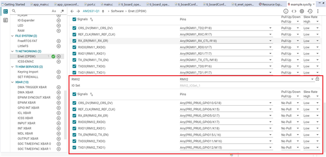

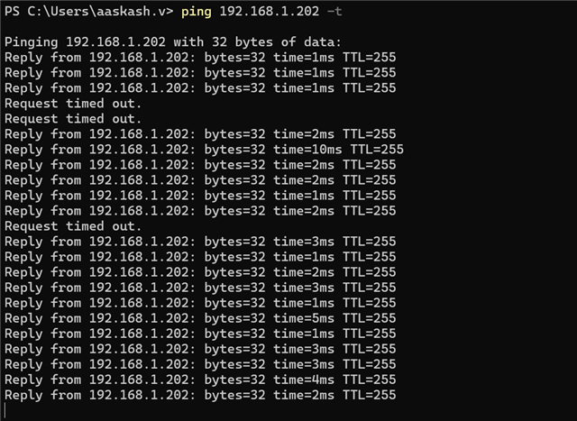

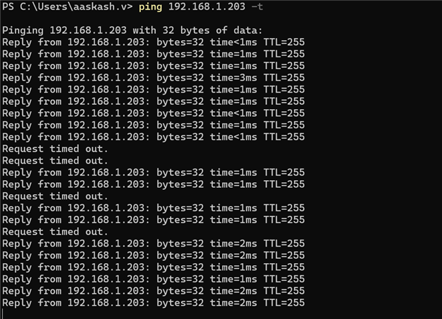

  • Hi Evan,
    I got the issue and resolved the issues due to sysconifg if u configure the pin it is not reflecting on  pinmux.c file so i raised one ticket in forum and i resolved that.so now i could able to ping both the ip's in debugging also in flash.
    so still i am facing the Request time out  issue can u say wat is the issues?

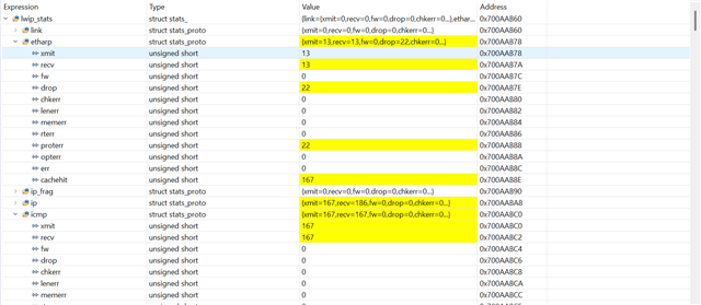

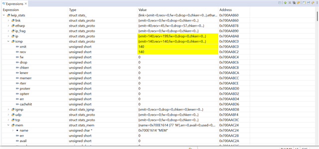

  • Hi AK,
    Glad to know that the other Pinmux RMII issue resolved this issue and you can Ping now. Request time out issue doesn't directly point to issue with AM26x, it can be due to network setup as well.
    In your application, can you open lwip_stats in the expression window (after halting the R5F core) and see if there are any packet drops for ICMP? If ICMP packets are dropped at AM26x side, then you will be able to see that here. You can refer: https://dev.ti.com/tirex/explore/node?node=A__AEIJm0rwIeU.2P1OBWwlaA__AM26X-ACADEMY__t0CaxbG__LATEST to get steps on checking lwip_stats. Also, check CPSW Stats and see if there are any packet drops at MAC Port level (refer the same page for steps).
    If we do not see any packet drops at CPSW or LwIP side, then I think the packet drops are due to some issues outside the scope of AM26x.
    Shaunak
  • Hi Evan,
    As per ur previous discussion i observed that, I am debugging the Code and I am monitoring at the time of request time out i pause my code and i am checking where the issue is happening so I can see every time if I get time out it is halt on this part.
    I observed in expression LWIP_STATS, here i observed packet drop is 0. in ICMP
    But in Etharp it show some drop.
    i am thinking that our server means hardware is sending the data and our driver code is Struk/halt somewhere at the time of Request time out and again after some time it is started sending the packet.
    because every time of debugging I observed that whenever it is request timeout going to happen pause my code and it was halt on TimerP_getCountPriv() this function.   --- this is just my observation.

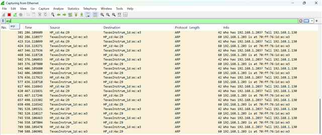

  • Hi AK,
    In your lwip_stats I do see some ARP protocol error packets. Can you please check the ARP packets being sent to the AM26x (probably through wireshark?)
    An ARP protocol error can indeed cause an ICMP timeout. ICMP (Internet Control Message Protocol) relies on ARP (Address Resolution Protocol) to map IP addresses to MAC addresses within a local network. If ARP fails to resolve an IP address to its corresponding MAC address, the ICMP echo request (like a ping) will fail, resulting in a timeout.
    Shaunak

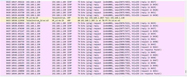

  • hi Shaunak,
    1. Here we are connected our ethernet directly pc -> mcu there is no intermediate
    I observed the ARP protocol error packets in the wireshark and i attached below.
    Below i filtered only the ARP protocols.
    can you say what is the solution for this
    1. I have one question i soldered the bootstrap resistor according to this thread which u mention above so is there any possibility that if we change our resistor our Request time out error will resolve?

  • Hi AK,
    Based on the wireshark screenshots filtered for ARP packets, I do not see any ARP error packets, infact, for every ARP request to locate an IP address, the MCU has responded with the relevant MAC address. Maybe there is some firewall blocking the packets from external world to the PC (you can check this as well to make sure no packets are dropped or there isn't a lot of traffic overload in the link). To avoid PC overheads as well, try to test with a Linux PC once
    This can also be due to signal integrity or timing issues. For RMII mode, I don't expect straps to make a difference if PHY link is up and able to transmit/receive from MAC & link partner. It could be the cause in RGMII mode with timing delays, but RMII mode has no configuration like this through straps
    Shaunak
