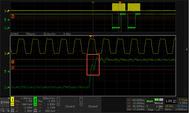

A few months ago, we push a question on the forum regarding the issue of half-level signals when reading flash data via OSPI, as detailed in this link:
e2e.ti.com/.../5739028
The topic has since been automatically closed, but we never received a clear explanation of the root cause or an effective solution to the problem.

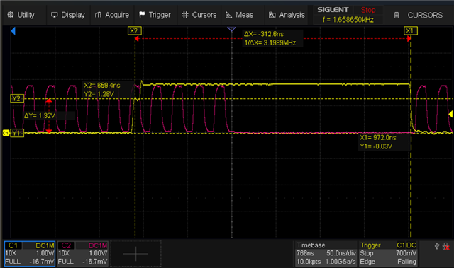

We recently conducted further testing using the EVM board and SDK examples. The issue can be reliably reproduced following the steps below. We hope TI's experts can continue analyzing this problem to determine its root cause and explore potential solutions.
1.  Import the SDK example project: "mcu_plus_sdk_am243x_11_00_00_15\examples\drivers\ospi\ospi_flash_dma\am243x-evm"
2. Unckeck "Enable PHY Mode" on example.syscfg->OSPI
3. Modify ospi_flash_dma.c file to fill the gOspiFlashDmaTxBuf array with all 0xFF
4. Debug the project and set a breakpoint at ospi_flash_dma.c:123.  Using an oscilloscope to capture the waveforms of OSPI_CLK and OSPI_DQ4.
5. Continue runing the project and we can capture the half-level waveform for OSPI-READ. 1=CLK, 2=DQ4

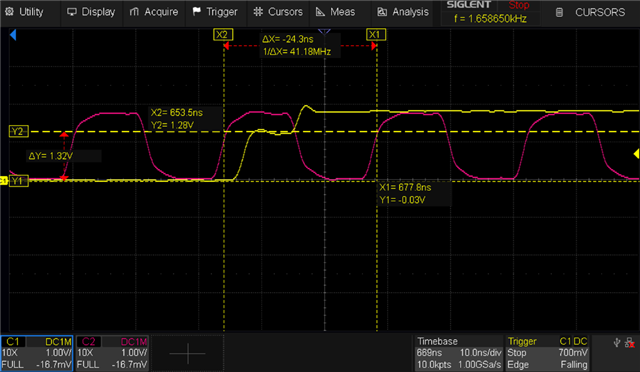

  • Hi Liang Luo,
    Sorry for delayed response. May I ask you a couple of questions?

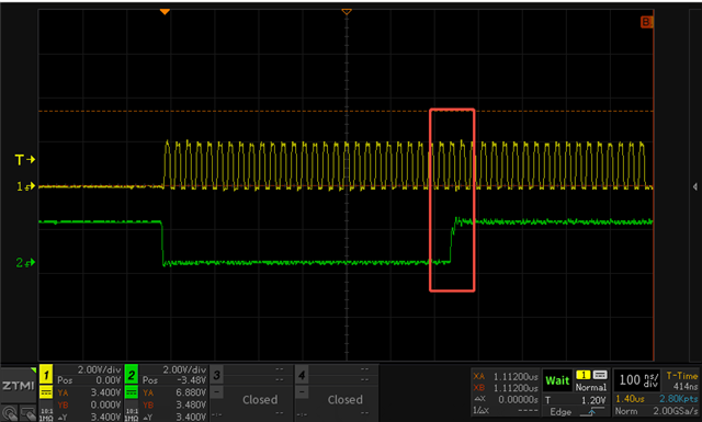

    1. In the original thread, Tony Tang says "Can capture it during OSPI booting also." Is this correct? We didn't see the half-level issue during OSPI boot.
    2. The waveform capture from the current thread:
    Differs from the waveform from the original thread:
    Is this now another issue or it is the same half-level issue captured with another possibly slower scope?
    Stan
  • Hi Stan,
    We checked again:
    Without half-level when load sbl, and with half-level when load application.
    So it seems that fsbl has adopted effective methods to avoid this issue.
    We think it's the same issue.

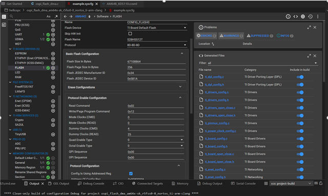

    I did your recommended modifications in the:
    1) extern.syscfg - where I disabled the PHY Mode.
    2) I modified the data in ospi_flash_dma.c (line 413) to 0xFFFFFFFFu
    3) Added the breakpoint on the line: Ln123:  "CycleCounterP_reset()" of the ospi_flash_dma.c

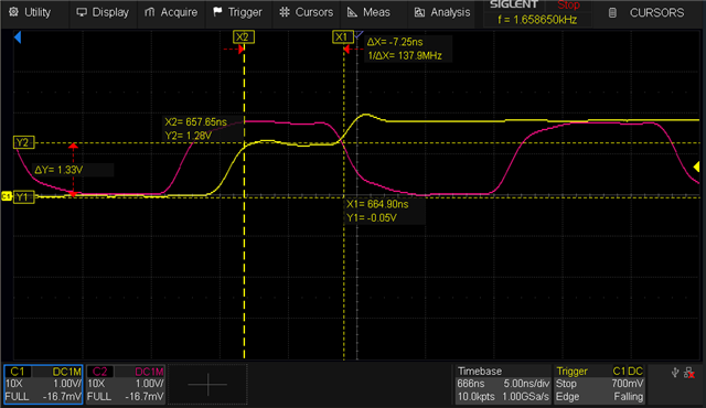

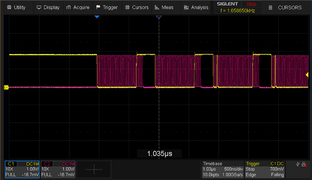

    I managed to capture 3 DMA data transfers in total, so generally it looks like:
    I captured the phenomenon in the below screenshots. Within the first DQ4 data bit duration, the line retains its level at 1.32V for approx. 7 - 8 ns after the initial rising and then the signal continues to rise up to 1.8V.
    The OSPI CLK line frequency is around 41 MHz. ( ~ 166.666 MHz / 4)

  • I captured the phenomenon in the below screenshots. Within the first DQ4 data bit duration, the line retains its level at 1.32V for approx. 7 - 8 ns after the initial rising and then the signal continues to rise up to 1.8V
    This is what we call the half-level problem.
    The default_sbl_null don't access the flash, and indeed there is no half-level issue when fsbl loads the sbl. Therefore, I gussest you compare the flash configuration differences between the fsbl and sbl/app to see if that can resolve the problem.

  • Liang,

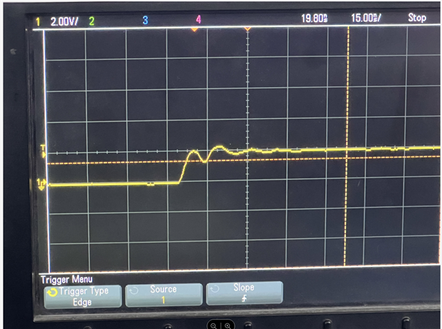

    This is looking like two separate issues based on waveforms with different behavior. But would like to ask some additional information to confirm.
    This captured waveform appears to be a reflection on a transmit since the signal dips instead of being maintained at a near mid supply level. I expect this is an AM243x write being measured at the far end.
    Can you confirm if the above is also measuring  the first bit of read data or is this capture a transmit/write from the AM243x device?
    This behavior is different as it is held constant at a mid supply step. This would indicate one of two potential possibilities to me.
    1) The measurement point being at the flash is capturing an expected reflection. When measuring LVCMOS signals at the source end there will be a mid supply step as the signal transfers until it reflects back and fully transitions to VDD.
    2) There is bus contention where both the AM243x device and the flash device are trying to drive the bus resulting in mid supply. I would expect this to only occur on the first read cycle and this can be adjusted by configuring dummy cycles as indicated in the previous thread.
    It is hard to tell but it seems like this mid supply is in every rising edge on a read
    It is important to understand that measuring at the flash device is the correct point for measuring AM243x writes, but will cause distortion on reads when the flash is driving the signal.
    If it is possible to measure a read cycle at the AM243x boundary it will be a helpful data point. If the mid supply step is eliminated it can be confirmed this is a measurement artifact. If it continues, the focus should be on dummy cycle configuration and eliminating bus contention.

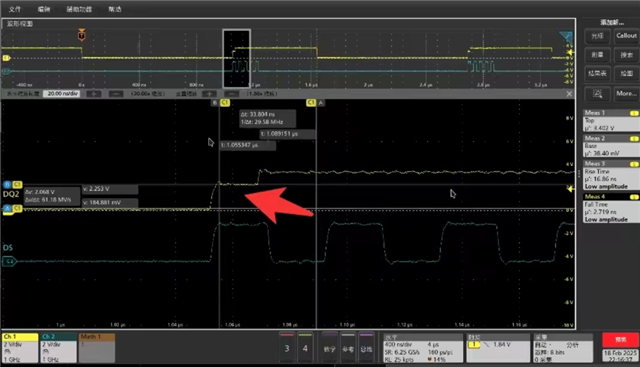

  • Hi Chris,
    Modifying the dummy cycle can eliminate this half-level but incorrect data will be read.  This was already elaborated in our previous topic: https://e2e.ti.com/support/microcontrollers/arm-based-microcontrollers-group/arm-based-microcontrollers/f/arm-based-microcontrollers-forum/1477203/am2434-ospi-read-command-first-bit-half-level-question/5739028?tisearch=e2e-sitesearch&keymatch=%20user%3A589657
    I also lack adequate conditions to test the signal from the AM243X proximal end. If it were signal reflection, shouldn't it occur every time the bit transitions from low to high? In addition, there is no half-level on the DQS pin. So  I think the possibility of signle reflection is relatively low.
  • Liang,
    Yes if the pink trace is measured at the flash and is DQS driven by the flash then I agree it would show the same behavior. Since it does not and based on the discussion in the previous thread it does appear related to dummy cycles and resulting bus contention. We will need to involve SW teams as this will likely require SW modification to resolve.
    Chris

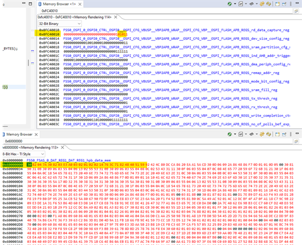

  • Here are the register values for OSPI.
    Just after ROM boots the values are as follows:
    OSPI FLASH IO Application with PHY and DMA enabled just after Board_driversOpen:
    Allow me sometime to see the difference in these.
  • Hello Vaibhav,
    Is there update?
    Thanks for your patience.
    I have reviewed the differences.
    Some of them of importance being:
    ROM:
    dummy cycles: 20
    DELAY_FLD bit value = 1
    OSPI FLASH IO:
    dummy cycles = 25
    Can you please try this commit and build the example. Please see if the half level issue is still seen with the changes in the commit:https://github.com/TexasInstruments/mcupsdk-core-k3/commit/490656d87db71516007f6b23fadca60ab3feffb2

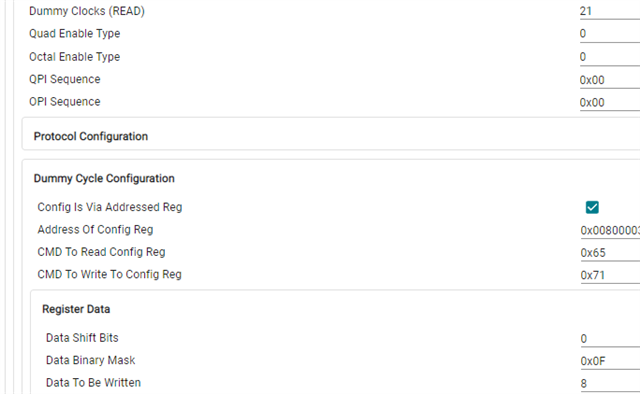

  • Hi Liang,
    Some observations based on debug I had with the SW team.
    When PHY mode is not checked(enabled) in the SysConfig GUI:
    Controller side Dummy Clocks (Read) should be equal to Flash side Dummy Clocks (Read).
    When PHY mode is checked(enabled) in the SysConfig GUI:
    Controller side Dummy Clocks (Read) should be 1 more than the Flash side Dummy Clocks (Read).
    If the value of clock frequency/divider <= 25 MHz, the Dummy Clocks (CMD) = 3

  • Hi Liang, Tony,
    Can you help classify the above waveform based on the following points?
    There are two issues that happen on the OSPI interface:
    • Bus contention – flash and SOC driving the bus at the same time will result in sustained mid level signal. Likely only first transfer.
    • Reflection – voltage actually drops below and shows some signs of ringing. Related to layout/trace length/board design. Can be helped with layout changes and potentially increasing drives strength. Will occur on ever low to high transaction.
    Looking forward to your response.
    Vaibhav
  • Hi Vaibhav,
    How you test this? If equal, incorrect data will be read.
    If the value of clock frequency/divider > 25 MHz and <= 50 MHz, the Dummy Clocks (CMD) = 4
    Why? The purpose of starting this thread is to understand the reasons behind such a configuration and how to resolve the half-level issue.
  • Hi Liang, Tony,
    Refer to the previous reply as show below.
    Hi Chris,
  • There are two issues that happen on the OSPI interface:
    What kind of response do you want from customer and me?
    We reported the issue, need BU team analysis, you kick the ball back to us to analysis?
    If need my option, I think it is Bus contention, because modify the dummy cycle number can eliminate the first bit middle level abnormal signal, but result is wrong. so I think it may related to the IP, suggest you work with IP vendor to analysis.
    It is not reflection definitely, because modify the dummy cycle eliminate the middle level signal.
    Since BU team reproduced the issue on EVM already, BU can verify ideas on EVM and provide conclusion to customer.
    Upon running the steps as mentioned by Liang.
    I have flashed default_sbl_null.cfg file on the AM243-EVM. And then upon loading the OSPI FLASH DMA via CCS and putting a breakpoint at line 123(with Phy disabled), I see that the first bit of DQ4 is as attached in the above diagram.
    I am not seeing the half level issue as seen by Anastas and Liang. My next step is see how Anastas ran the setup differently compared to mine.
    Vaibhav
  • Hi Vaibhav,
    I think your waveform also reproduces the issue; otherwise, the voltage level of the first clock wouldn't drop this much. It's possible that your oscilloscope's performance is poor or it isn't grounded with the product, which might be why the waveform isn't very clear.
    Additionally,
    1. How you test this? I tried and receive incorrect data
    2. Have you confirmed that this isn't the cause?

  • Hi Liang,
    I ran some experiments. I do not see any bus contention and the erase, writes and reads happen correctly as well.
    With the same dummy cycles read setting of 24 on the Controller and 24 on the Flash side, I am able to read the values.
    I have debugged this and found out the following observation: (In SysConfig for OSPI FLASH DMA, have both Controller and Flash read cycles set as 24)
    1. In Flash_norOspiOpen function, we firstly set the readDataCapDelay value while reading the device and manufacture id. (no action required for this step by the customer, just explaining the flow.)
    2. Post this step, while in application, ask the customer to put a breakpoint at the following line:
    3. This will ensure that the DAC is enabled. Now, in memory browser go the address 0x60000000. Here you will see the bootloader image flashed and it should begin with something like 30 82 .. .. .. and so on.
    4. You will find out that the bootloader image is bit jumbled up with a bunch of “00 00”s in between. I see this in my setup.
       (image got flipped when I took a screenshot due to some glitch)
    5. I figured out this might be a readDataCaptureDelay problem.
    6. So, I changed the value of the register 0xFC40010 bits[1:4] to 5 and it worked for me. Previously bits [1:4] was configured as 1, now the updated value I wrote was 5, so now with bits[1:4] as value 5, I see the correct contents as shown in the image below:
    7. I would like you to test with values from 15 until 0, and tell me which value gives them the correct contents at 0x60000000.
    Next Steps:
    If this is replicated at the customer’s setup, then the next steps can be suggested.
    Vaibhav
  • Hi Vaibhav,
    I tested on EVM board, and bit[1:4] = 4 or 5 is OK, other value NOK.
    Next Monday, I'll test our own board to see if the effect is consistent
  • Hi Liang,
    I will wait for your results on Monday.
    Please have 24 and 24 dummy cycles as mentioned in the steps above and follow the same for your own(custom) board as well.
    If not 5, then try for other values as well from 15 until 0.
    Looking forward to it.
    Vaibhav
  • Hi Vaibhav, on our board(S28HL256T/S28HL512T), 5 and 6 is OK, other value is NOK.
