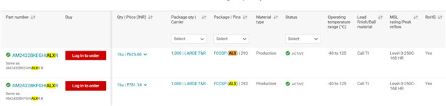

Please refer to the MSL rating
Pls let me know if this helps.
