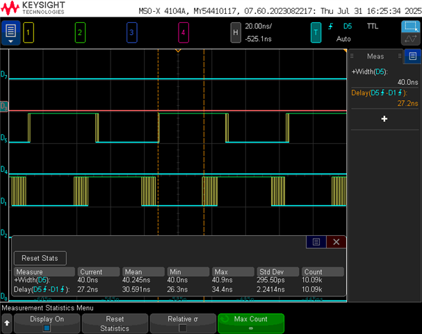

I am currently using the PRU in SD Mode. To use GPIOs, I have to rely on the General-Purpose Interface (GPIO). My issue is that the timing of these external peripherals is less precise and shows some unusual behavior.
The test program is quite simple and generates a PWM signal. Pin multiplexing is handled by an R5F program, following the configuration described in the corresponding FAQ article, using the same settings.
    LDI     R1.w2, 0x60
    LDI     R1.w0, 0x1000   ;GPIO1 Baseaddress (0x601000)
    LDI     R2.w0, 0x18     ;GPIO_SET_DATA01 offset
    LDI     R3.w0, 0x1C     ;GPIO_CLR_DATA01 offset
    LDI     R4.w0, 0x01     ;bit 1 -> output 0
CHECK_PROCESSING_TIMING:
    SBBO    &R4, R1, R2, 4  ;set General-Purpose Interfaces connected Pin High
    SET     R30, R30, 1     ;set PRU connected Pin 1 High
    NOP
    NOP
    NOP
    NOP
    NOP
    NOP
    NOP
    NOP
    NOP
    SBBO    &R4, R1, R3, 4  ;set General-Purpose Interfaces connected Pin Low
    CLR     R30, R30, 1     ;set PRU connected Pin 1 Low
    NOP
    NOP
    NOP
    NOP
    NOP
    NOP
    NOP
    NOP
    JMP     CHECK_PROCESSING_TIMING
    HALT
When the timing is correct, as demonstrated in the example code, the signal from the General-Purpose Interface shows a delay of approximately 27ns plus one clock cycle (3.3ns) with acceptable jitter. However, if I remove just one operation from the loop and the period no longer aligns with some internal timing of the SoC, I observe significant jitter in the General-Purpose Interface output. The standard deviation is 2.24ns, and the delay can vary between 26.3 and 34.4ns plus one clock cycle (3.3ns).
Is there a way to achieve always the better timing performance when using the PRU with the General-Purpose Interface?

  • Hello Niklas,
    Pin accesses: PRU GPI / PRU GPO vs "regular" GPIO
    A big reason why we have PRU cores on this device is that the PRU GPI / PRU GPO signals have a completely deterministic latency from inside the PRU core, to the processor pin (and from the pin to the processor). In general, if you care about nanosecond precision, these are the signals that you should be using.
    Accesses outside of the PRU subsystem are not going to be fully deterministic for multiple reasons. I have not benchmarked this specifically, but I would not be surprised if there was some nanosecond jitter for accesses to the system GPIO modules. You will also probably find that average latency to access GPIO0 is slightly different than the latency to access GPIO1, one of the SPI interfaces, etc.
    You can find more information here:
    [FAQ] What is a PRU core? Why are PRU GPIO signals different from regular GPIOs?
    And then some more information about read and write latency can be found here:
    [FAQ] PRU: How do I calculate read and write latencies?
    FYI, I am going to add some comments to your code block to make it a bit easier for future readers to interpret
