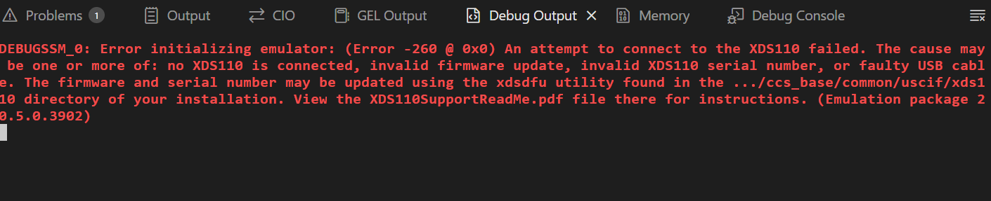

AM263P4-Q1: DEBUGSSM_0: Error initializing emulator: (Error -260 @ 0x0) An attempt to connect to the XDS110 failed.
Part Number: AM263P4-Q1
Other Parts Discussed in Thread: AM263P4

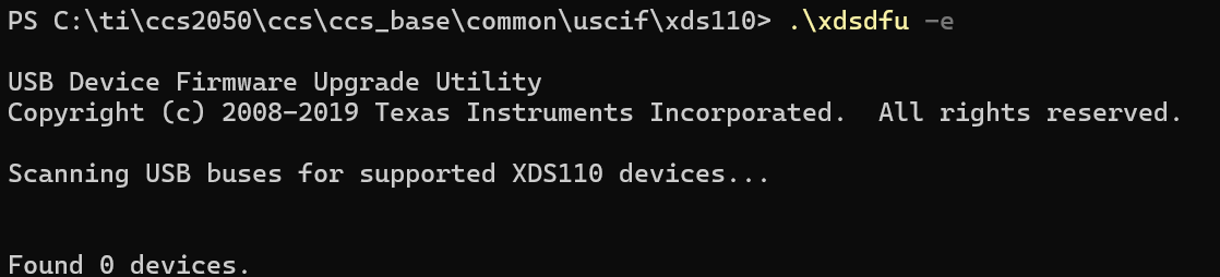

Hi Team,
While working with the Launchpad board(AM263p4-LP) facing JTag Issue, and we tried some streps based on XDS110SupportReadMe document but found 0 device, please see the below screen shot for your reference. Let me know how to resolve the issue.

    Thank you for reaching out and providing the screenshots. The error message and the "Found 0 devices" result from xdsdfu -e indicate that the XDS110 on-board debugger is not being recognized by your PC at the USB level. This is typically a prerequisite issue before firmware updates can even be attempted.
    Please work through the following steps in order:

    Thank you for your support. We followed all the steps you suggested, but unfortunately did not get any results.
    The power LED is blinking, however the XDS110 debugger LED is not blinking, and the XDS110 is not appearing in Device Manager. We are using Windows 11, and the version of Code Composer Studio is 20.5.0.
    Please let us know if there are any further steps we can try.

    Based on your symptoms — power LED blinking but XDS110 debugger LED not blinking, the device not appearing anywhere in Device Manager, and xdsdfu -e returning "Found 0 devices" even after trying different cables and ports — this strongly points to the on-board XDS110 debugger hardware being non-functional. However, there is one last recovery procedure worth attempting before concluding hardware failure.
    Try the TDO Pin Grounding Recovery
    This procedure has resolved bricked/unresponsive XDS110 debuggers on other TI EVMs where the XDS110 firmware became corrupted (e.g., from a failed CCS firmware update) [1]:
    1. Disconnect all cables from the LaunchPad.
    2. Locate the TDO pin of the XDS110 controller (TMD41294NCPDT) on your AM263P4-LP board. You'll need to identify the equivalent of Pin 97 (TDO) or a corresponding test point — check the LaunchPad schematic for the exact location.
    3. Ground the TDO pin — connect it to any ground point on the board (e.g., a GND test point).
    4. While TDO is grounded, connect the USB cable to the XDS110 USB port.
    5. Keep the pin grounded for about 5 seconds, then remove the ground connection. (Note: some users have reported needing to keep TDO grounded through the entire recovery process.)
    6. Run xdsdfu -e from C:\ti\ccs2050\ccs\ccs_base\common\uscif\xds110\ to check if the device is now detected.
    7. If detected, flash the firmware: xdsdfu -c 1 -f firmware_3.0.0.29.bin -r
    8. Verify with xdsdfu -e again to confirm the firmware version.
    If this procedure does not cause the XDS110 to appear, repeat steps 1–5 — the timing can be sensitive [1].
