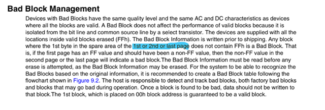

Due to a recent change in NAND chip, we will need to enable scanning of the last page for bad block markers.
For reference, to detect/mark a bad block, we will need to check the first, second, and last pages of a block (Pages 0,1,63).
While looking through the `nand_base.c` file inside the U-Boot package(SDKLA AM62x (v10.01.10.04)), we found it was possible to enable the last page scanning option by enabling the NAND_BBT_SCANLASTPAGE chip option.
However, during analysis and testing of the feature, we discovered a bug that prevents this feature from functioning correctly.
As shown in the image above, if both NAND_BBT_SCANLASTPAGE and NAND_BBT_SCAN2NDPAGE are enabled, it will cause the following incorrect behavior:
  1. Mark last page of selected block
  2. Mark first page of next block
A similar logical error also exists in the bad block check function.
To fix this issue, we have added the following modifications attached in the file below (Please convert .txt file to .patch file for easy use):
 nand_base.c 0001-NAND-Bad-Block-Management-Fix.txt
Please let us know if there are any issues with this change/fix.
  • Hi Marwan,
    In general, u-boot writes the Bad Block Marker (BBM) to the OOB area in the first and/or the second page within a erasable block.
    Writing the BBM to additional pages does not typically improve reliability but can introduce compatibility issues or slow down your system's boot process.
    This is one reference on bad block management in AM64x ROM on GPMC-NAND booting
    [FAQ] Bad Block management in AM64x ROM on GPMC-NAND booting
    1/. What is the gpmc-nand device on the Valeo board?
    2/. Is there a special requirements to writer the BBM to multiple pages, (i.e 0, 1, 63) within a erasable block?
    -Hong
  • Hello Hong,
    1. There is not a single NAND device we will be supporting; rather, we will support multiple NAND device variants by reading their ONFI parameter page and adjusting accordingly.
    2. There are some NAND suppliers that require BBM in multiple pages as shown below.
    Is this feature supported through a different method than I described in my original question above? If that is the only way, then it is not correctly functioning.
  • Hi Marwan,
    I checked with Linux SDK 10.0.7.4 on AM62-LPSK board.
    It looks like BBM is placed only in the first byte of the first page OOB area within a erasable gpmc-nand block in the u-boot.
    -Hong

  • Hello Hong,
    From what I see, this is the default behavior, but it is supposedly configurable using the NAND_BBT_SCAN2NDPAGE and NAND_BBT_SCANLASTPAGE flags I described above.
    Does this mean that the SDK does not support the marking of bad blocks in the second and last pages of a block?
    Marwan
  • Hi Marwan,
    Yes, BBM is logged in the first byte of the first page OOB within a erasable block in the default u-boot.
    It looks like the NAND_BBT_SCAN2NDPAGE/NAND_BBT_SCANLASTPAGE flag is not typically enabled in u-boot, but is instead triggered automatically based on the NAND chip's manufacturer ID and internal properties. For example, Samsung & Hynix MLC NAND device, and Toshiba & AMD devices.
    - Samsung
    https://git.ti.com/cgit/ti-u-boot/ti-u-boot/tree/drivers/mtd/nand/raw/nand_samsung.c?h=12.00.00.07#n99
    - Hynix
    https://git.ti.com/cgit/ti-u-boot/ti-u-boot/tree/drivers/mtd/nand/raw/nand_hynix.c?h=12.00.00.07#n72
    - Toshiba
    https://git.ti.com/cgit/ti-u-boot/ti-u-boot/tree/drivers/mtd/nand/raw/nand_toshiba.c?h=12.00.00.07#n68
    Triggering the flag in the code based on the the NAND chip's manufacturer ID would ensure consistency between u-boot and kernel...If the bootloader and kernel disagree on where to look for bad block markers, they may accidentally write to a block one considers "good" while the other knows it is "bad," leading to data corruption.
    -Hong
  • Hello Hong,
    I appreciate the examples provided; however, my original statement is very clear:
    When both the NAND_BBT_SCAN2NDPAGE and NAND_BBT_SCANLASTPAGE flags are enabled, bad block marking and detection does not function correctly.
    Please confirm this behavior on your end, and review the fix mentioned above.
    Marwan
