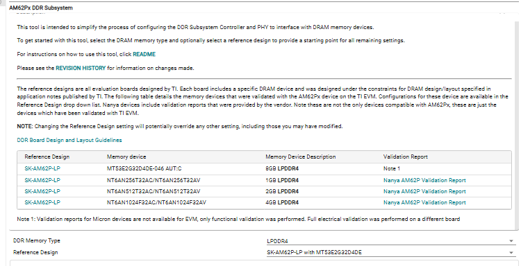

In the DDR SysConfig Tool (https://dev.ti.com/sysconfig/), I created a new project, and configured as follows:
    - Software Product: DDR Configuration for AM64x, AM625, AM623, AM62Ax, AM62Px, AM62Dx, AM62Lx (0.10.40)
    - Device: AM62P
    - Package: FCBGA (AMH)
    - Variant: AM62P54 Quad Core A53, Features M. Base features, plus Multimedia JPEG Encoder and Display Subsystem

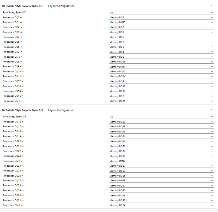

Then I modified these settings:
    - Reference design: SK-AM62P-LP with MT53E2G32D4DE
    - Bit Swizzle / Byte Swap for Bytes 0/1
    - Bit Swizzle / Byte Swap for Bytes 2/3
I changed the Bit Swizzle settings according to our schematics.

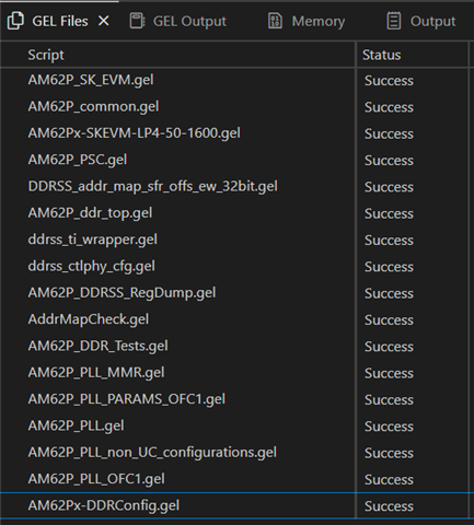

Then, I have successfully done the steps described in this post: AM62P: AM62P DDR tests: Error -1170 @ 0x0 Unable to access the DAP. - Arm-based microcontrollers forum - Arm-based microcontrollers - TI E2E support forums
I am able to connect to the board with the XDS110 Debug probe using JTAG, and I can see the DDR test scripts.
The custom GEL file has loaded properly:
I can successfully run  Scripts -> AM62 DDR Initialization -> AM62P_DDR_Initialization_ECC_Disabled.
