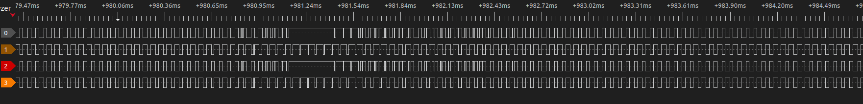

I am working with the LP-AM263P4 development board and am generating complementary PWM signals using PWM1 and PWM3.
My target configuration is:
  • PWM Frequency: 20 kHz
  • PWM Period: 50 µs
However, I am not getting the expected output. Initially, the PWM waveform matches the expected behavior, but after some time it changes unexpectedly. This pattern repeats at the same interval every time.
I have attached:
  • Output waveform screenshots
  • ti_driver_open_close.c source file
My main application code is shown below:

0 is PWM1 A , 1 is PWM1 B
2 is PWM3 A, 3 is PWM3 B

    However, I still have one concern regarding the waveform behavior.
    Even after considering the above points, the PWM output initially appears correct and then changes periodically before returning to the expected waveform, repeating at a fixed interval. Since the compare values are written only onceI would not during initialization and are never updated afterward, expect the waveform to change during runtime.
