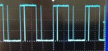

    Thanks for the answers. It's difficult to explain. I do an other try:
    What I want is something like this
    What I get is this:
    The red break- in's are not desired. The problem is the the Generators are synchronized.
    Does anybody know more about this?
    Thanks and regards
    Thomas

    I drew some diagram for a better decription.

     Hi Thomas, can you capture on scope and post it ? Also capture together a toggle pin on a port to see where update are located. ( your X point and I suppose interrupt begin/end)

    from tag [] I infer this:
     You are working on a Connected launchpad on processor TM4C1294NCPT
     Before to got lab I suppose you know the issue you got, red lines are some form of negative pulse or glitch?
     Prepare to also help Amit a test doing this and reproduce issue:
     Toggle a port bit entering/exiting interrupt servicing port
     Toggle another port bit before/after set PWM
     Capture on scope PWM output and these two port output too.
     As Amit requested compress your code and decide if can be posted on public area or privately send to.
     Initial writing is interpreted this way:
     You are using 3 compare channel on same counter.
     You loaded Counter load setting the PWM period (and this is same for all 3 channel of same counter)
     You set an interrupt on zero counter and service do this:
       Change load of all 3 channel.
     From your sketch:
      x to x is the pwm period from load register and is same on both
      period before load is near 16.66% 1 about of 6 pulse width fit the period so pwm ->1/6
     After load you wish have one full period set to 1 (so 100% duty cycle) then I suppose reload old 16% value to extend on next period.
    Period of     PWM      1   2   3   4   5   ...   n   n+1 n+2 n+3
     PWM % sequence : 16 16 16  16 16  ... 100 16     x    y ...
     When you set new pwm you got a glitch on first red or output goes down?
     You get a strange thing I didn't fully grasped, try one of this if more close to:
     1 You expect pwm change extending next cycle to all the period (100%) and some glitch are on output
     2 You expect extending and new value don't load?
    try some simple sequence explaining and don't worry language I provide CB1 punishment and continue in my information drill-out ;)

    From one pulse to the next is one pwm Periode. My aim is it to invert the pwm output in each periode and if i do this I get pulses before every inversion. I think this is because it took to long to invert the output.
    I invert the output in my count to zero interrupt. I tried to do the inversion earlier, but the controller does not wait until the counter counts to zero (lokal synchronization).
    Thanks for help.

     I find one part has no sense so I barred it. Setting PWM and 100-PWM alternately generate a square wave as the one is on scope screen. More detail are necessary.
  • Hello Thomas,
    It would be good if you can post the code. The local synchronization works fine on TM4C123.
    If the intent is to invert the output then that cannot be synchronized to zero count, but based on the code we can surely find a way around it.

     Hi, from your scope image I suppose it is an analog one, positive spike appear less thick as negative one, is your code acting different on positive or negative update? If scope is digital changing sampling rate image change due to aliasing or spikes are of different width?
