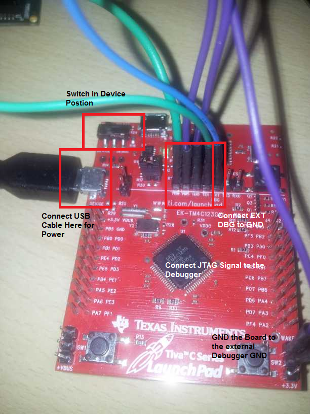

i am new to this microcontroller, currently i have TM4c123GXL, and currently i planned to design it to the schematic. since the board is connected 2 tm4c123g together 1 as ICDI and another 1 is for device purposed. just curious to ask, if i remove all the ICDI just left D+ and D-, will the microcontroller can be reprogramme in future or only certain function Eg: GUI to microcontroller only and not able to reprogramme the TM4C?
thank you
hope can be reprogram if i use only USB D+ and D-

  • Hello Kelvin
    There is a direct header for 10-pin ARM debugger on the EK-TM4C123GXL for programming the main uC. I have not used it so far, but can check and confirm the steps/process that will allow you.others to do so
    Will post the update by tomorrow.
    Amit

  • Hello Kevin,
    The picture on the previous post was for using the ICDI uC on the EK-TM4C123GXL as a debugger for another TM4C board/device.
    Amit
  • Hello Kevin,
    I tested the same with the blinky program and it works with an external debugger. What I have shown in the picture will work. I have not used the ICDI uC or the 10-Pin Header at the bottom of the EK-TM4C123GXL (cost consideration for the latter)
    Amit
  • hi Amit
    thank for the help, just would like to confirm some information for the clarification
    the connection as you shown above is for the main uC in the evaluation (not sure am i say correctly or not), what if i want to program on the PCB which i going to prototype in few weeks time, connection as same as above extend the jumper as below to the prototype board for reprogram purposed?
    TCK ----> PC0
    TMS ----> PC1
    TDO ----> PC3
    TDI ----> PC2
    thank
    Kelvin

  • Hello Kelvin,
    So how are you connecting CCS to the evaluation board currently and what do you plan to use in the future: via Stellaris ICDI on the EK board, XDS100?
    Please note that we do release the ICDI uC binary image, so you may have to use XDS debugger or hot wire EK-TM4C123 to the end product board.
    Amit
