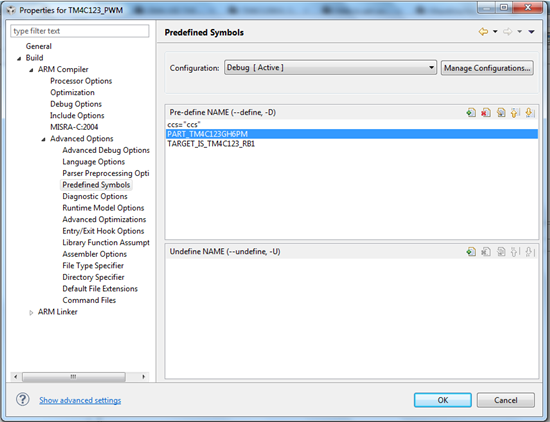

  • Hello Vikram,
    Have you put the define PART_TM4C123GH6PM in the pre define section of CCS?
    Amit
  • Hello Amit ,
    I have CCS v6.
    No I had not done what you asked!
    To put the define I did this:
    rightclick on project name->Show Build Settings->C/C++ General->Paths and Symbols
    Then under the Symbols tab I added PART_TM4c123gh6PM
    It isnt working! even when the error goes away!
  • Hello Vikram,
    Right Clock on Project -> Show Build Setting
    Amit
  • Hello Amit,
    I have made the proposed changes and i have added the header file pin_map.h which has elimated the error.
