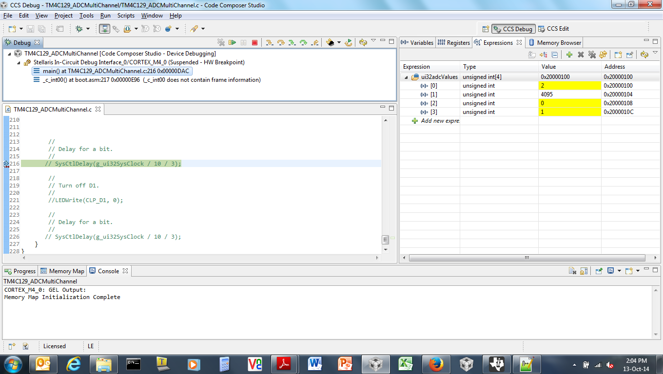

when i modified the code like above you mentioned , its reading only the CH1 values , other 3 channel values not updating. pls refer the attached picture.

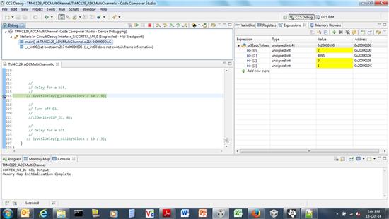

Yes Amit,
I am changing the voltage values , 0 and 3.3v in all PE0,PE1,PE2 and PE3 pins but it changes the value in adcValues[0] none of other are not changing the value
my doubt is this following ADC Read Call with 0 is correct for reading CH1 ,CH2,CH3 values?
ADCSequenceDataGet(ADC0_BASE, 0, adcValues)

Hi Amit,
I want to read external temperature.
Yes if i use only one Channel , the working perfectly but when i want use multi channel like CH0 (temp1), CH1(temp2), CH2(temp3) and CH3(temp4) its not working.
I want to read the voltage across the 4 Channels pins (PE0,PE1,PE2,PE3)
Ashok r

Yeah , Please find here attachment

Ashok r
Hello Ashok,
I tested the code on my DK-TM4C129 by connecting one-by-one PE0, PE1, PE2 and PE3 to 3.3V and remaining to GND.
Also the ALWAYS_TRIGGER and the PROCESSOR_TRIGGER don't go hand in hand since the Always trigger will cause a trigger to occur all the time and when you use the variable window the data will shift as the sampler is working but the CCS has halted the CPU
New Code as below:

Attached is the snapshot of the Memory Window and it reads fine.
Amit
