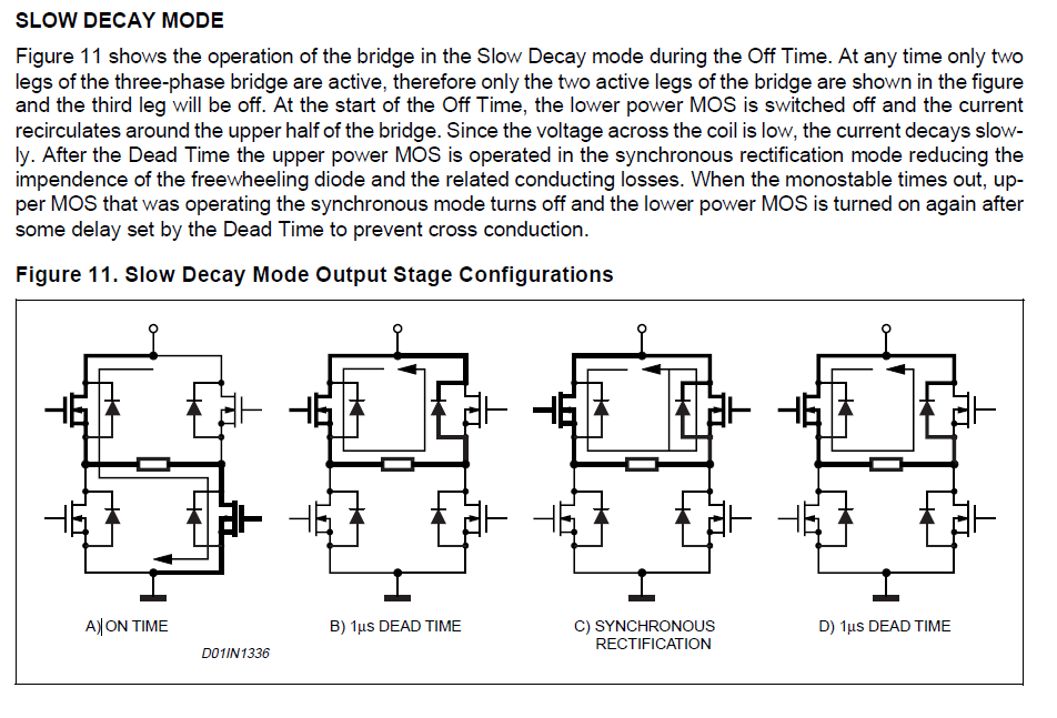

  • > Can & does "restore" PWM output upon the very next PWM cycle - when the analog comparator signals, "all is well."
    This food has me thinking about ISO9002 safety valve in such a robust topology:
    Perhaps an auto brake drive would be more fitting if current exceeds the maximum while (PWM_GEN_MODE_FAULT_MINPER) strikes the 18us PWM bell more than a few 100 times.
    Wonder how that might be implemented?
