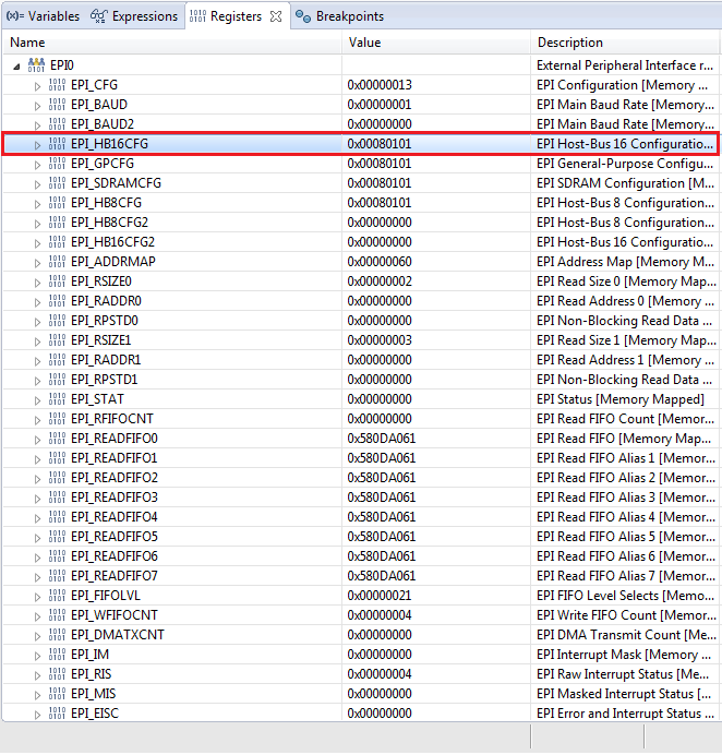

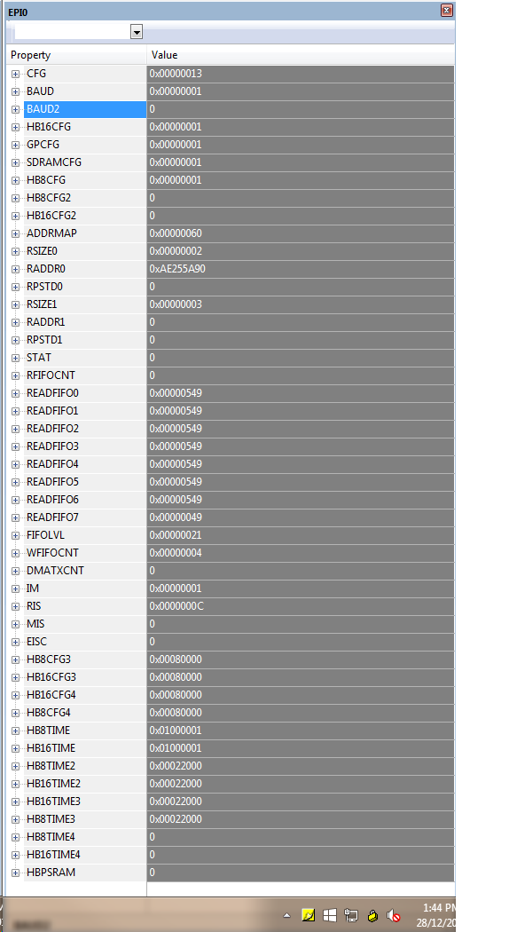

    Here is a copy of the EPI registers. Hope its what you are asking for.
    Khaled.
  • Hi Amit,
    It seems the snap shot of the registers were not uploaded.
    Here they are again.
    Khaled.
  • Hello Khaled
    Attached is the snapshot of the code when I ran it on my side. What is different is that the EPI HB16CFG register on my setup shows a value of 0x0008.0101 while the same on your setup shows 0x0000.0001
    Amit
  • Hello Amit,
    EPI_HB16CFG register set to 0x0008.0101 value is for iRDY disabled. You have to set it to 0x1008.0101 to enabled it.
    Correction to my previous e-mail, my EPI_HB16CFG register was set to 0x10080101 (uVision interface was displaying the wrong value but the memory display was correct).
    This is said my problem is not resolved. When iRDY bit is enabled, and the iRDY pin is asserted low, everything works fine. When iRDY pin is de-asserted high, I loose control over the Cortex (can't use break points in the debugger, and I cant erase the Flash anymore). Only if I re-assert iRDY low or if I use Lm Flash Programmer that I can have access to the Cortex again.
    Khaled.
  • Hello Khaled,
    The code file had the READY Enable commented.
    EPIConfigHB16Set( EPI0_BASE,
    // EPI_HB16_IN_READY_EN | //IRDY enabled
    EPI_HB16_MODE_ADDEMUX | //sets up data and address as separate
    When IRDY is enabled and the level matches the active level then the CPU bus will be stalled till the same is not resolved. That is why the debug connect is not possible and you have to use LMFlashProgrammer to unlock the device using JTAG Mass erase. Th iRDY is a stall function which must be resolved by the external device.
    Amit
  • Amit,
    I commented out the iRDY enable command on purpose to get my testing going.
    I more or less reached the same conclusion as you: the external device has to assert high the iRDY in order for the Cortex not to stall indefinitely.
    My original question still stands: is there is a way to configure the Cortex/Epi interface/iRDY NOT TO STALL the cortex indefinitely?
    In my case, if the external device do not assert the iRDY signal, the Cortex dies as well and the entire system is lost!
    Khaled.
