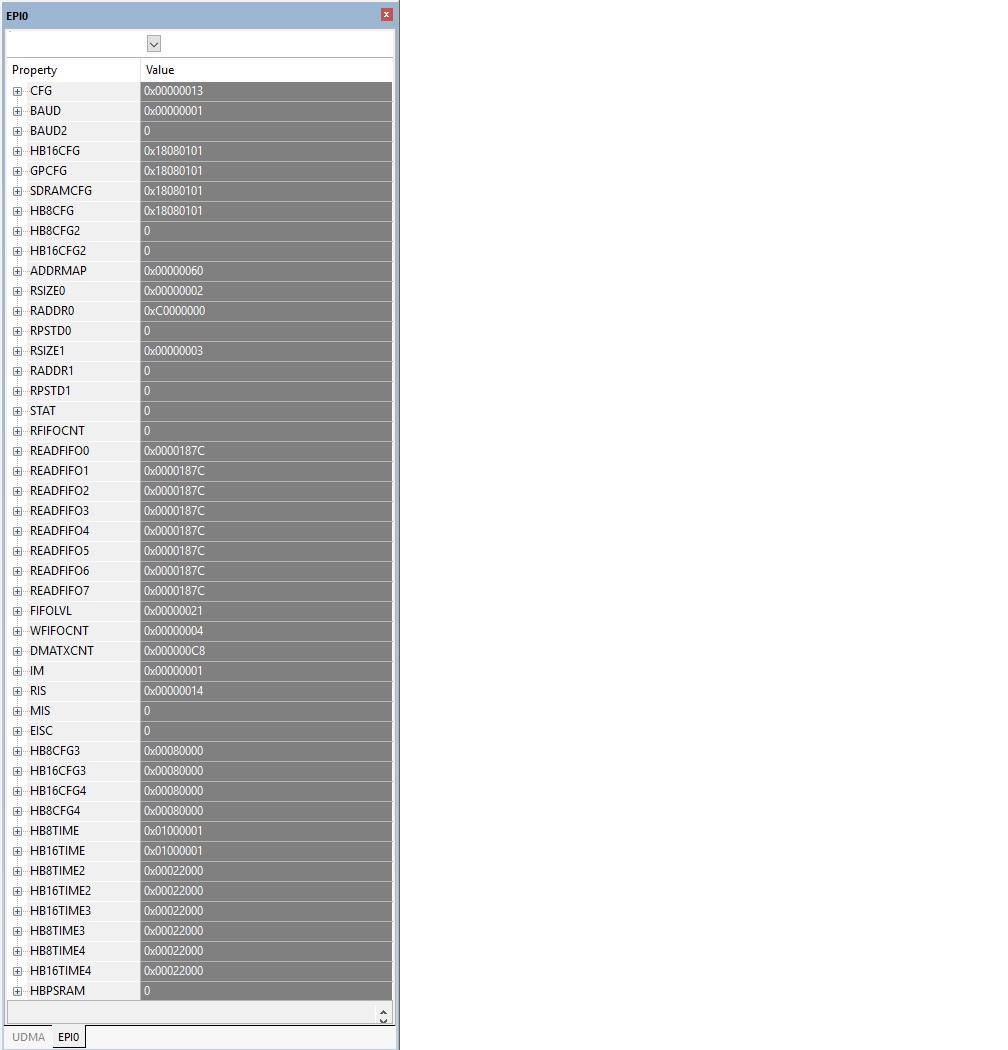

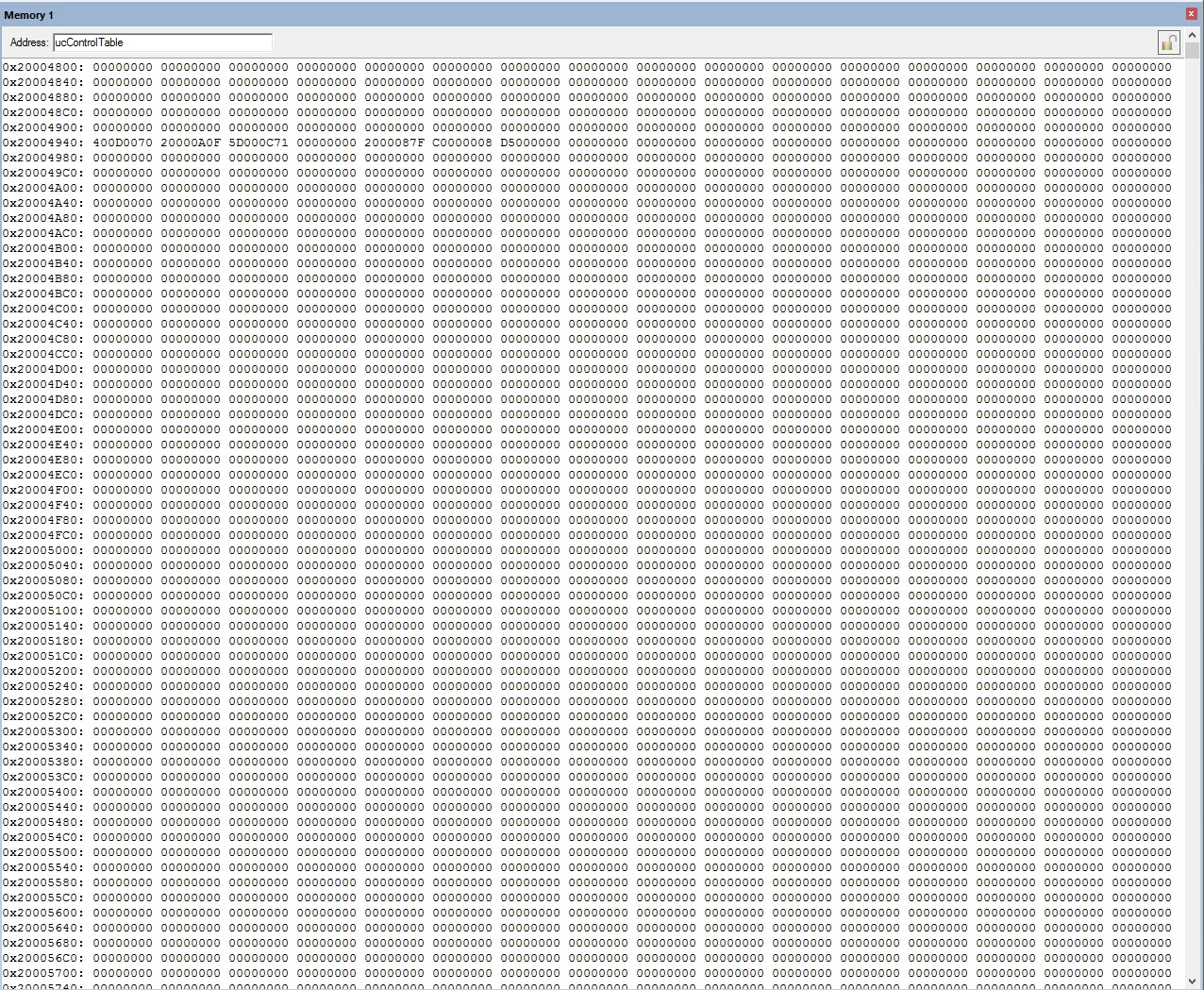

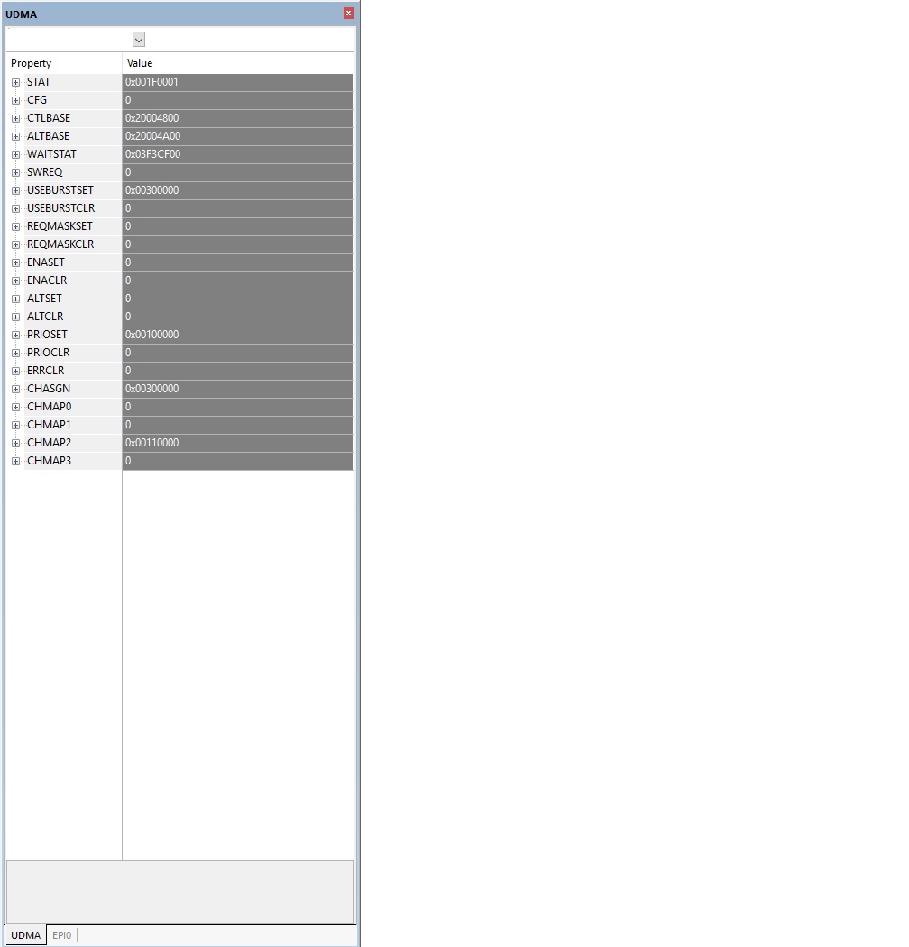

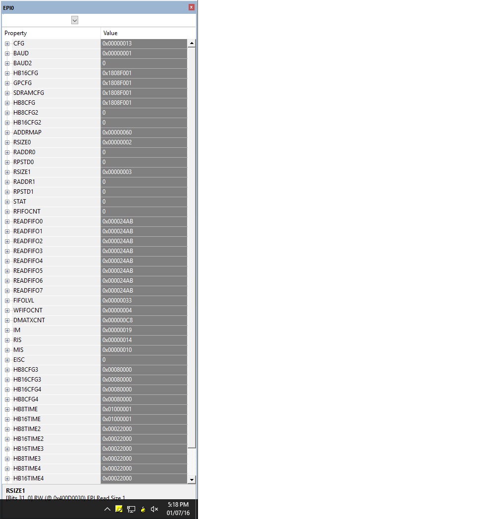

I'm having trouble getting the EPI uDMA write to function properly.
I have EPI write (no uDMA) working, EPI read (no uDMA) working and EPI uDMA read working.
From my tests it seems that the EPI uDMA is not even starting!
Please help.
Khaled.

  • Hello Khaled
    Since I do not have a similar setup, I would require the following information
    1. The EPI register dump for all EPI registers
    2. The uDMA register dump for all DMA registers
    3. The uDMA primary control table in SRAM for the values programmed in the channel control structures, when the write does not occur
    Amit
  • Hi Amit
    Here are the 3 information captured just before calling uDMAChannelEnable(UDMA_SEC_CHANNEL_EPI0TX) that should write the data.
    I'm attaching the same information captured just before calling uDMAChannelEnable(UDMA_SEC_CHANNEL_EPI0RX) that should read the data.
  • Hello Khaled
    The data sheet specs the following
    "A μDMA request is asserted by the EPI WRFIFO when the TXCNT value of the EPIDMATXCNT register is greater than zero and the WTAV bit field of the EPIWFIFOCNT register is less than the programmed threshold trigger, WRFIFO, of the EPIFIFOLVL register"
    In the configuration above the WTAV is more than WRFIFO.
    I am trying to setup a TX transfer with SDRAM and uDMA to see if that indeed is the cause...
    Amit
  • Ok, but what caused the WTAV register to have a larger value than WRFIFO? how much larger are we talking about? is a single word larger or multiples?
    thanks.
    Khaled.

  • Hi Amit,
    Thanks for the effort that you are putting into this, but my problem is still un-resolved.
    I tried to adapt you code to HB16 interface but nothing has changed: The uDMA write is still not working.
    I'm not sure what will be the next step, but our customers are waiting for the new board and I can't give the go ahead until this interface is working!
    Khaled.
  • Hello Khaled
    Is the iRDY holding off the bus?
    Amit
  • I will probe it and get back to you. But most likely its not. As I mentioned before the following accesses are working fine:  Non uDMA read, Non uDMA write, and uDMA read.
    The only non working access is the uDMA write.
    If it was the iRDY, I would have seen the problem with the Non uDMA write as well.
    Both Non uDMA write and uDMA write functions shares the same code until the last few instruction.
    In the non uDMA case I do a direct write
    for(i = 0; i < count; i++) {
    word            = src_p[i];
    *g_pusEPIFPGA =  (word         ) & 0xFFFF; g_pusEPIFPGA++;
    *g_pusEPIFPGA = (word >> 16) & 0xFFFF; g_pusEPIFPGA++;
    EPIWriteFIFOEmpty(TRUE); //wait write fifo to be empty
    In the uDMA case write I program the uDMA to send the data
    EPIDMATxCount( EPI0_BASE,count * 2);
    uDMAChannelTransferSet( UDMA_CH21_EPI0TX, UDMA_MODE_BASIC, src_p, (void *)g_pusEPIFPGA, count * 2);
    uDMAChannelEnable( UDMA_CH21_EPI0TX);
  • Hello Khaled
    Since you have proven that non-uDMA read write and uDMA read work fine, the interface is OK. It is a software configuration that is not working which has to be analyzed.
    I would suggest checking it with a SDRAM board if you have access to one?
    Amit
  • Hi Amit,
    I fully agree with you: its a configuration problem. But what? that is what is driving me crazy. I checked every instruction and every register but I'm not able to find the error. I was hoping that you will be able to find it for me.
    I don't have an SDRAM that is connected to the HB16 bus. This is a home made board that connect the Cortex M4 to Ti's TMS320C6472 HPI bus.
    However, as per your instructions, I did asked our technician to solder probes to the HB16 control bus (including the iRDY). I should be able to have the modified board today.
    Khaled.
  • Hello Khaled
    I would suggest soldering the probes on the all the critical signals so that we can see what is happening on the bus for the control signals.
    Amit
  • Hello Amit
    Did as you have suggested and I think I have the first clue: The address bus is not toggling when performing a uDMA write!
    In my case, I"m using a single address bus A0 to act as a half word strobe to the TM320C6472: A0 is low for the 1th 16bits, and high for the second 16bits.
    Now the question, is why?
    Khaled.

  • Hi Amit,
    One last issue with the HB16.
    Now that I have uDMA write transferring data properly, the EPI interrupt handler keep triggering endlessly with EPI_INT_DMA_TX_DONE flag.
    I'm not able to clear it.
    There is a EPIIntErrorClear(EPI0_BASE, intStatus) function to clear the error flag, but no function to clear the uDMA done flag!
    Khaled.
  • Hello Khaled
    You have to use the API as follows.
    EPIIntErrorClear(EPI0_BASE, EPI_INT_ERR_DMAWRIC);

  • Hi Amit
    Here is the registers values captured as soon as I enter the EPI handler.
    Khaled.
  • Hello Khaled,
    The EPI register WFIFOCOUNT is not "0". Hence the EPI is requesting the DMA for more data, but since the DMA transfer size has decremented to 0 and the channel mode automatically turned to STOP, the DMA Done is being asserted by the DMA which is what is causing the Interrupt to fire again.
    You need to make sure that the Transfer Size in the control structure of the DMA and the WFIFOCOUNT register value is correctly programmed
    Amit
  • Hi Amit,
    I'm confused. I thougth that the EPI WFIFOCNT == 4 means the the fifo IS empty.
    Here is my Epi init and Epi uDMA write function. could you please take a look.
    void EPI_HPI_uDMA_write(uint32_t *src_p, uint32_t  count, uint32_t *dst_p) {
     // Set pointer to EPI memory mapped window.
