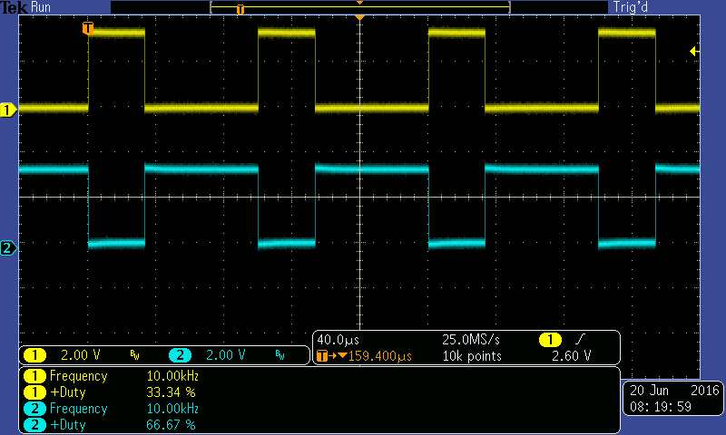

Many have asked here for clarification (nitty-gritty) of the MCU's PWM Generators.   While this vendor's MCU manual & Peripheral User Guide are intensive - they do not fully/completely guide prospective users.   Firm/I do not offer "cookbook" style code - illustrated here are several key (yet not all) capabilities of a single, PWM Generator w/in TM4C MCU series.
Dual Outputs of a PWM Generator - identical frequency yet fully independent Duty Cycle.
Switching from "independent" to "complementary" outputs via, "PWMDeadBandEnable()" function w/ parameter values zero'ed.
Note that (ONLY) the addition of "PWMDeadBandEnable()" caused the switch from "independent PWM Output to Complementary!"

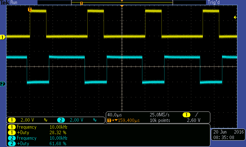

         And now Complementary Outputs w/Dead-band parameters set to 200.
Notably - at least by firm's/my read - vendor's manual does not explicitly list, "How to invoke Complementary" PWM Outputs.   Such is here (now) revealed...
Vendor may wish to add - at some point,  "Use of "PWMDeadBandEnable()" function yields the complementary PWM Output (defined by PWM_A) via PWM_B."   As outsider - such suggestions are (most always) "duly noted" yet rarely (i.e. never) survive into vendor's "official" note...   (and vendor's "round file" (surely) over-flows w/such "NIH" suggestions...)

    Some way/how it was claimed that falling edge (under dead-band) was difficult to view. (i.e. required "video" pause - you/I knew that such was "unlikely" - scope caps here confirm.)
