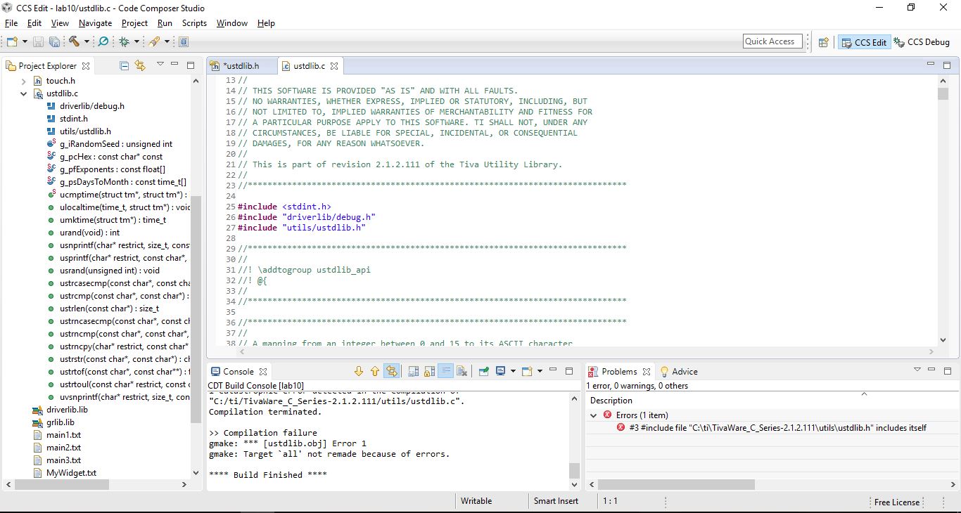

#10010 error and #10234-D unresolved symbols remain
Other Parts Discussed in Thread: TM4C123GH6PM
After i imported the Lab 10 file from the TM4C123G_LaunchPad_Workshop, when i debugged it, these errors appeared. Is there a way to fix it? Thanks in advance!

    Add also ustdlib.h file to your project, and in file using the call to usprintf(), add an #include "ustdlib.h" .
    Can be fixed also other way, if you read again and compare the lab documentation with your file (i.e use symbolic links for ustdlib.* files).
    Thanks for the earlier reply! The ustdlib.h file is already inside the ustdlib.c file, and I've added the #include ustdlib.h inside the ustdlib.c which has the usprintf. But now it has this problem where the .h file includes itself. Can i have your guidance once again? Sry for the inconvenience.
    Eisen
    No, not in  ustdlib.c file, but in the file which uses a call to usprintf(), whatever is that - main.c or what you have. The linker complains because it does not know where to find it, and the compiler should emit some warning because it is a function call without a prototype.

    I'm sorry that i forgot to add the errors just now.
    Here it is:

    "C:\ti\TivaWare_C_Series-2.1.2.111\utils\ustdlib.h", line 27: fatal error #3: #include file "C:\ti\TivaWare_C_Series-2.1.2.111\utils\ustdlib.h" includes itself
    1 catastrophic error detected in the compilation of "../grlib_demo.c".
    1 catastrophic error detected in the compilation of "C:/ti/TivaWare_C_Series-2.1.2.111/utils/ustdlib.c".

  • Hello Eisen
    Completely unrelated is TARGET_IS_BLIZZARD_RB1 must be TARGET_IS_TM4C123_RB1
    I wanted the error log before you added the ustdlib.c

    After changing it to TARGET_IS_TM4C123_RB1, I'm still getting this error:
    Description Resource Path Location Type
    #3 #include file "C:/ti/TivaWare_C_Series-2.1.2.111/utils/ustdlib.h" includes itself .ccsproject /lab10 line 27, external location: C:\ti\TivaWare_C_Series-2.1.2.111\utils\ustdlib.h C/C++ Problem
    This is the error message from the build console for your reference:

  • Hello Eisen
    I have attached lab10.zip
    Make sure that the TIVAWARE_ROOT is defined as C:/ti/TivaWare_C_Series-2.1.2.111 in the imported project.
    To change it Right click your project, "Show Build Settings", then click on the "Build" in the pop-up,  navigate to the tab "Variables", double click the variable and edit the path.
    Once this is done, clean and rebuild the project.
    lab10.zip
    Amit
    Thanks for the help, I got it working alr!
