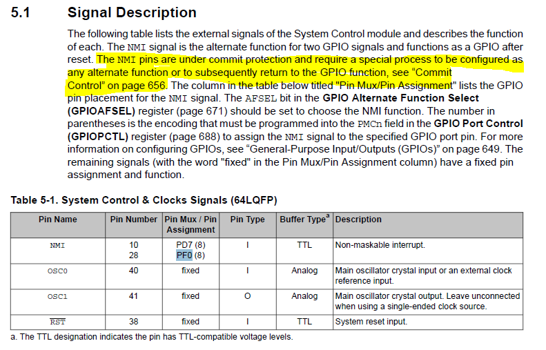

CCS/TM4C123GH6PM: I can not set PF0 to high or low in tm4c123g development board
Part Number: TM4C123GH6PM
I use example "hello.c".
This is my code.

I set PF0 to high or low, I always measure 2 voltage in this pin.
Where do I need to set it?
  • Might that occur as you (likely) "missed" the known fact that PF_0 defaults into "NMI" status - which precludes your use for (other) purposes!
    You must employ the special, "Pin Unlocking Procedure" - which is detailed w/in MANY posts here - and accessed via "Search Box" (atop the forum.)
    Or - faster & more simply - you may AVOID troublesome "PF_0" and (partner in identical crime, PD_7) by using a "normal" GPIO, instead.     Thus no "delightful" extra effort is demanded!
    Many of your fellows have fallen victim to such an unwise & unwanted "NMI default."     No/Zero effort has been made to correct this short-coming - which always results in posts "such as yours."
  • CB1 is correct. Here are some snippets from the datasheet describing the condition.

  • cb1, Bob,
    Trying to be proactive, a few Datasheet places where a at least a footnote could be added:
    - Table 23-2 Signals by Pin Number
    - Table 23-3 Signals by Signal Name (both next to the PF0 entry AND next to anything else that can be used on same physical pin)
    - Table 10-2 GPIO Pins and Alternate Functions
    And in the DRL-UG, chapter 14.2.3.19 - GPIOPinConfigure() - could add the information that "this function does not unlock protected pins such as NMI, which must have their registers unlocked prior to a function change".

  • Thanks you all,I tried all yours suggestion and the problem solved now.
    Many thanks,
    WeiYu
