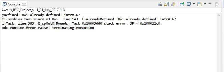

During execution of my application, Often I am getting the below error,
l.Task: line 383: E_spOutOfBounds: Task 0x200028dc stack error, SP = 0x20000ce4.
xdc.runtime.Error.raise: terminating execution
I am using almost 9 task with each task having 512Kb stack size. I have used 4 event handler and 4 mailbox.

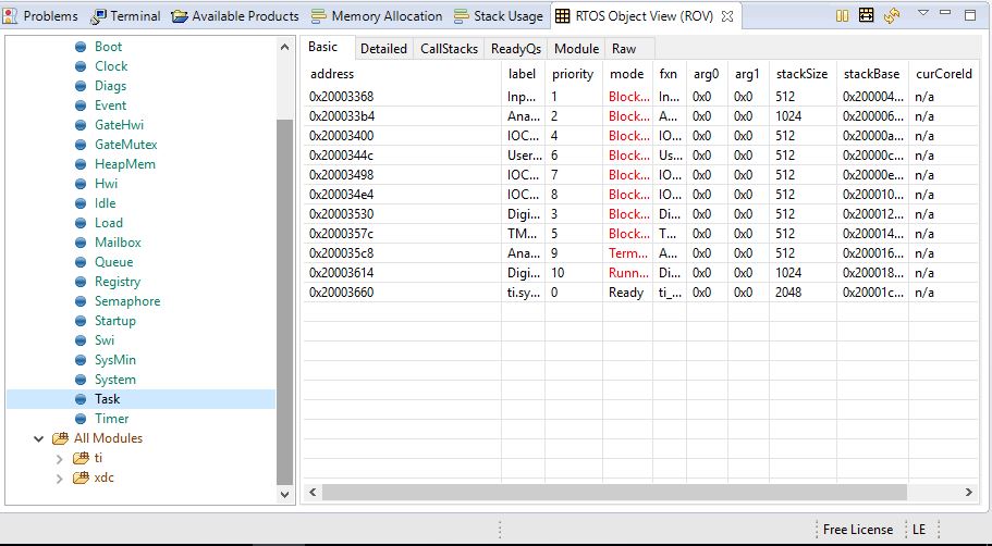

    I have found that the above error is because of Idle task with the address in the Error.
    And I have gradually increased the idle task stack size from 512 to 2048. Since I am getting the same error.
    Question:
    1.I want to know how to resolve this error, its not getting resolved even if I increase the stack size of idle task.
    2. Any other approach to resolve this issue?
