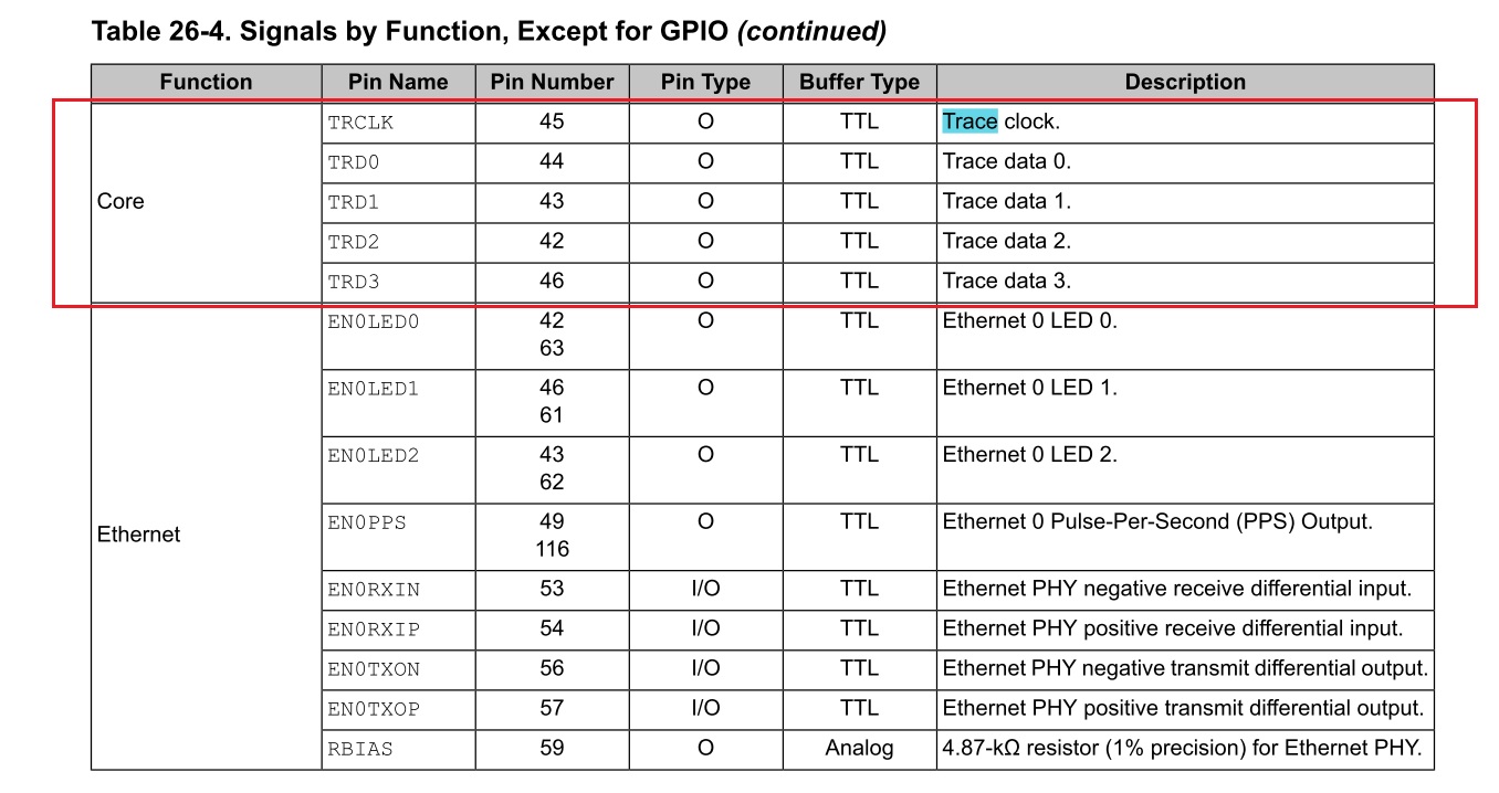

    2> What's the "Trace" function?
    The TRD0-3 and TRCLK provide for the ETM Trace on the TM4C129x devices. You can refer to the ARM CSDK for further information.
