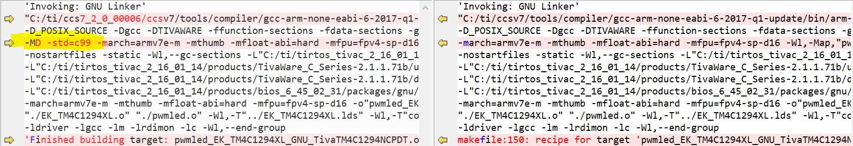

I was moving my non-RTOS SPI codes to RTOS. I have noticed that in C:\ti\tirtos_tivac_2_16_01_14... example for spi loopback is provided so wanted to check it. I am getting this error once project is imported and I try to build it:
'Invoking: GNU Linker'
"C:/ti/ccsv7/tools/compiler/gcc-arm-none-eabi-6-2017-q1-update/bin/arm-none-eabi-gcc.exe" -DPART_TM4C1294NCPDT -D_POSIX_SOURCE -Dgcc -DTIVAWARE -ffunction-sections -fdata-sections -g -gdwarf-3 -gstrict-dwarf -Wall -march=armv7e-m -mthumb -mfloat-abi=hard -mfpu=fpv4-sp-d16 -Wl,-Map,"pwmled_EK_TM4C1294XL_GNU_TivaTM4C1294NCPDT.map" -nostartfiles -static -Wl,--gc-sections -L"C:/ti/tirtos_tivac_2_16_01_14/products/TivaWare_C_Series-2.1.1.71b/grlib/gcc" -L"C:/ti/tirtos_tivac_2_16_01_14/products/TivaWare_C_Series-2.1.1.71b/usblib/gcc" -L"C:/ti/tirtos_tivac_2_16_01_14/products/TivaWare_C_Series-2.1.1.71b/driverlib/gcc" -L"C:/ti/tirtos_tivac_2_16_01_14/products/bios_6_45_02_31/packages/gnu/targets/arm/libs/install-native/arm-none-eabi/lib/armv7e-m/fpu" -march=armv7e-m -mthumb -mfloat-abi=hard -mfpu=fpv4-sp-d16 -o"pwmled_EK_TM4C1294XL_GNU_TivaTM4C1294NCPDT.out" "./EK_TM4C1294XL.o" "./pwmled.o" -Wl,-T"../EK_TM4C1294XL.lds" -Wl,-T"configPkg/linker.cmd" -Wl,--start-group -lgr -lusb -ldriver -lgcc -lm -lrdimon -lc -Wl,--end-group
makefile:150: recipe for target 'pwmled_EK_TM4C1294XL_GNU_TivaTM4C1294NCPDT.out' failed
c:/ti/ccsv7/tools/compiler/gcc-arm-none-eabi-6-2017-q1-update/bin/../lib/gcc/arm-none-eabi/6.3.1/../../../../arm-none-eabi/bin/ld.exe:configPkg/linker.cmd:9: syntax error
collect2.exe: error: ld returned 1 exit status
gmake[1]: *** [pwmled_EK_TM4C1294XL_GNU_TivaTM4C1294NCPDT.out] Error 1
makefile:146: recipe for target 'all' failed
gmake: *** [all] Error 2
**** Build Finished ****

  • Hi Lukasz,
    Can you confirm there are no errors in the build? Can you paste the entire build output into a file and attach it (please don't copy/paste in a forum window...it makes it hard to read).
    I was able to build the example. The only difference I see is the "-MD" and "-std=c99".
    But when I removed these, it still built.
    Can you do a clean and then manually delete the debug and src directories in the project and then try building.
    Todd
    I have tried cleaning and deleting dubug/src directories. Same errors.  I have tried using differed XDC tools thinking that there may be some compatibility issue but with no success. Same happens when I try to use for instance pwm example. However, network examples like tcpecho work fine. Those use by default different compiler. I didn't notice other differences.

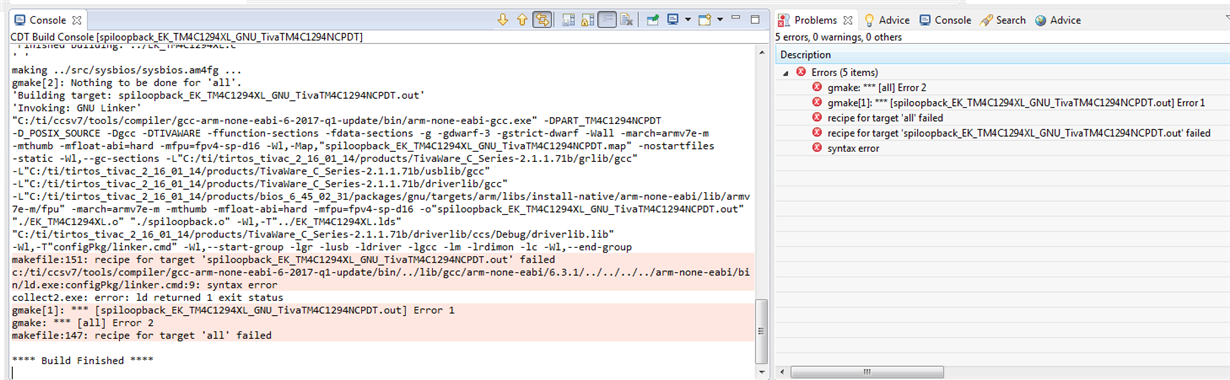

  • Strange. Can you attach the whole output like this:
    **** Build of configuration Debug for project pwmled_EK_TM4C1294XL_GNU_TivaTM4C1294NCPDT ****

  • Sure. I attach a file.
    **** Build of configuration Debug for project spiloopback_EK_TM4C1294XL_GNU_TivaTM4C1294NCPDT ****

    'Building target: spiloopback_EK_TM4C1294XL_GNU_TivaTM4C1294NCPDT.out'
    "C:/ti/ccsv7/tools/compiler/gcc-arm-none-eabi-6-2017-q1-update/bin/arm-none-eabi-gcc.exe" -DPART_TM4C1294NCPDT -D_POSIX_SOURCE -Dgcc -DTIVAWARE -ffunction-sections -fdata-sections -g -gdwarf-3 -gstrict-dwarf -Wall -march=armv7e-m -mthumb -mfloat-abi=hard -mfpu=fpv4-sp-d16 -Wl,-Map,"spiloopback_EK_TM4C1294XL_GNU_TivaTM4C1294NCPDT.map" -nostartfiles -static -Wl,--gc-sections -L"C:/ti/tirtos_tivac_2_16_01_14/products/TivaWare_C_Series-2.1.1.71b/grlib/gcc" -L"C:/ti/tirtos_tivac_2_16_01_14/products/TivaWare_C_Series-2.1.1.71b/usblib/gcc" -L"C:/ti/tirtos_tivac_2_16_01_14/products/TivaWare_C_Series-2.1.1.71b/driverlib/gcc" -L"C:/ti/tirtos_tivac_2_16_01_14/products/bios_6_45_02_31/packages/gnu/targets/arm/libs/install-native/arm-none-eabi/lib/armv7e-m/fpu" -march=armv7e-m -mthumb -mfloat-abi=hard -mfpu=fpv4-sp-d16 -o"spiloopback_EK_TM4C1294XL_GNU_TivaTM4C1294NCPDT.out" "./EK_TM4C1294XL.o" "./spiloopback.o" -Wl,-T"../EK_TM4C1294XL.lds" "C:/ti/tirtos_tivac_2_16_01_14/products/TivaWare_C_Series-2.1.1.71b/driverlib/ccs/Debug/driverlib.lib" -Wl,-T"configPkg/linker.cmd" -Wl,--start-group -lgr -lusb -ldriver -lgcc -lm -lrdimon -lc -Wl,--end-group
    makefile:151: recipe for target 'spiloopback_EK_TM4C1294XL_GNU_TivaTM4C1294NCPDT.out' failed
    gmake[1]: *** [spiloopback_EK_TM4C1294XL_GNU_TivaTM4C1294NCPDT.out] Error 1
    makefile:147: recipe for target 'all' failed
  • Thanks. Can you import the example into a location with no spaces? I'm thinking (hoping) "Prof. Leeb" and "Dropbox (MIT)" are causing the problem.
  • I have all of my workspaces there and nothing happens. I will try that.
  • Oops. I thought the split would leave the last post here! That was the issue. I split off a follow-up question.
