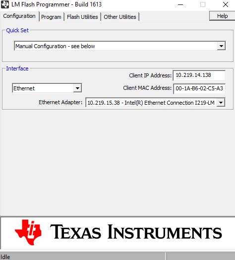

     When you run emac_boot_flash bootloader, what did you put into the Client IP Address in the LM flash programmer? I will suggest you revert back to the original emac_boot_flash bootloader bootloader and boot_demo_emac_flash examples and use the LM flash programmer again.
    Below are the steps you need to take.
    1. Program the TivaWare example such as enet_lwip into the MCU flash via the JTAG interface using CCS or LM flash programmer.
    2. Run the enet_lwip and you should see the IP addressed printed out on the terminal window. You need to record this IP address. This IP address is dynamically generated by the DHCP server. This IP address needs to be used later when you run the emac_boot_flash example. The reason is that the PC running the LM flash programmer is also a BootP server as well as the TFTP server. The BootP server is static in nature. You need to manually associate a client's IP address with the client's MAC address in a fixed table in the BootP server.  Note the only purpose to run the enet_lwip is to obtain an IP address. Once the dynamic address is acquired it is leased on your network for some hours. You might be able to configure your router to lease an IP address indefinitely. Check with your IT department.
    3. Program the emac_boot_flash into the MCU's flash via the JTAG interface. You can use the CCS or LM flash programmer to load the code. Note the emac_boot_flash starts at 0x0.
    4. Run the emac_boot_flash bootloader. The emac_boot_flash is supposed to send the BootP request now. However, since you have not yet launched the BootP server the client will just keep sending the request. If you have a wireshark you should see the BootP requests at 1s, 2s, 4s, 8s and so on.
    5. Open the LM flash programmer. See below. Enter the IP address that you just acquired from running the enet_lwip into the Client IP address field. Next enter the MAC address of your client. If you are using the LaunchPad you should see the MAC address on the sticker at the back of the board. What you are doing here is more like manually updating the BootP server's table of IP address and MAC address association.
    6. Go to the Program tab and specify the boot_demo_emac_flash.bin as your application program image and hit the Program button. See below.
    7. Give some time and you should see the download happening via the Ethernet.

  • Hi Michele,
     It works for me. The magic packet comes from the LM flash programmer. The eflash should be the command line version of the LM flash programmer so it should work similarly even though I never tried the eflash myself. 00:1a:b6:02:c5:a3 is my MAC address. You will have your own MAC address.
     You should be able to see the below on wireshark.
  • Hi Charles,
    I now see the packet. The problem has been solved.
    I have two ethernet cards, let's say card1 and card2. The LM Programmer allows me to choose only the card1, that is the correct one.
    However, the LM programmer has started to work as expected only when I have disabled card2.
    For future reference, I have used Win10 -64 bit.
    Thanks for your clarification and your support.
    Michele
