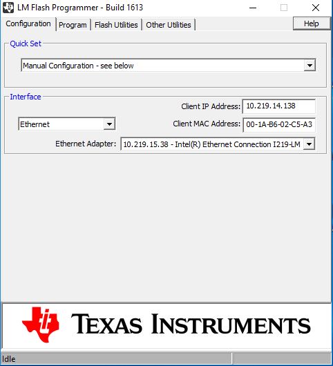

I tried using the boot emac flash example to flash code to a TM4C1294 Launchpad to flash code using Ethernet.
I have used the same lwipopts file as in the enet)lwip example and used static ip for the bootloader example.
I have checked that the assigned static ip is actually assigned to the board by putting breakpoints in the lwipinit function present in the example code. However when I try to now flash my application program using ethernet, I am getting an error , "problem starting the BOOTP server".
What am I doing wrong?

  • Hi Apoorv,
    Did it work if you change to DHCP?
  • Hi Charles.
    Thanks for the quick reply.
    I tried hosting a DHCP server, but no IP is assigned to the board for the boot emac flash example program. On the contrary, when I try to run the enet_lwip example with the same changes in lwipopts.h and lwipinit function, an IP address is assigned to the board by the dhcp server.
    That is the reason I switched to a static ip.
    Apoorv
  • Hi Apoorv,
    The bootloader code has to be small and efficient. Hence it does not have DHCP client implementation that gets the IP address. Instead it has a very basic BOOTP (older version of DHCP) implementation, that can only receive BOOTP packets.
    My earlier question to you whether you had it working using DHCP was based on your statement that you integrated the lwipopts file configured for static address into the boot_emac_flash example. What if you configure the lwipopts for DHCH and will it work? The boot_emac_flash by itself without any modification will not send DHCP discover/request packets to the DHCP server.
  • Hi, Charles,
    Do I need to run a bootp server on my laptop using some software (any utility for windows 10)?
    I have pasted the code for lwipopts.h which I have used. Also which file can I debug to see the bootp packets? Also, how to know which IP has been assigned ?

  • Hi Apoorv,
     The PC running the LM Flash Programmer can act as the BootP server. Please note that the MAC and IP address association for BootP is done statically meaning you will need to enter them  manually. Unlike DHCP where the IP address is dynamically leased to the client for a period of time. With that said, how do you know which IP address to associate with the MAC address of your MCU? This is why before running the boot_emac_flash you need to run another TivaWare ethernet example such as enet_lwip. The enet_lwip example uses DHCP server. Once the DHCP gives the IP address, the IP address is leased for a period of time. Before the IP address is expired, you can reuse the same IP address to associate with the MCU's MAC address for the BootP server. See below image where I enter the IP address that i got by running enet_lwip and the MAC address on my LaunchPad.
  • Hi Charles,
    Thanks for the reply.
    What is the difference between the example programs boot_emac_flash and boot_demo_emac_flash? (Is it the only difference that 1 example uses uip while other uses lwip?)
    I did exactly what you had suggested.
    I got the ip as 192.168.1.1 assigned by the DHCP server for enet_lwip example.
    Then I configured the same ip and MAC address in LM flash programmer utility. Then, I tried to program both example programs bin image (boot_emac_flash and boot_demo_emac_flash) but in both the cases, I had the same error from LM Flash Programmer : Problem starting the bootp server. What am I doing wrong here?
    Apoorv
