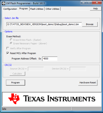

Respected sir/madam,
               First of all i am really sorry for asking same question again and again. But i am really stuck here. Previous threads are locked so i have to create new .
             Finally i have got my custom board and i am trying to program it for first time. The things i have done so for are
1. I populated  part of my custom board required for programming.
2. Checked all power and ground pins for proper supply.
3.I am trying to program boot_demo1.c example and i changed the pins (switch and led) according to my board.
4. I did manual configuration of LM flash programmer for UART as shown in attached snap and tried to program the board using boot_demo1.bin file.
5. But i am getting error as shown in attached snap.
So please tell me what is the problem or am i missing any step??

  • Are you using a 25MHz crystal? Sometimes the bootloader gets confused if you do not have a resistor of 4.89K between RBIAS and GND.
  • May I note that - for (any) "First Time Deployed" NEW BOARD -  "Bringing it up"  via  "JTAG/SWD" -  proves,  "SO VERY MUCH PREFERRED!"
    KISS dictates:  "Simple, Limited, Focused"  FIRST STEPS.     Any bootloader - by definition - proves MASSIVELY in Violation!      Note that for (any) "New Board" - issues could be "Anywhere!"    Thus the value of the tightly focused, measured, KISS-dictated approach!
    It is hoped that the (Normal/Customary)  "Provisioning of JTAG/SWD" - was included on poster's (custom) board.   (as that ALWAYS proves wise/SAVING)
    As always - use of the smallest/simplest program (i.e. "blinky") - should be the first "Program Load" attempted.      (and that - via JTAG/SWD)
    Only after that  "JTAG/SWD Success" - should any more ambitious  "Programming Attempt"  - be launched...
  • respected sir,
                    Yes i am using 25 Mhz crystal.
    There is 4.7k resistor between Rbais and GND which gives value of 4.529 K on DMM.
    Another question is can i boot load without using external crystal at all (using internal oscillator to reduce probability of error)??   If yes, what are the changes i have to make in boot_demo1 and boot_serial example or  changes in other places??
    regards,
    digvijay

  • Yes, if the part is erased, the boot loader should work. Have you verified with a scope that the serial TX signal from the PC is getting properly to UART0RX pin PA0? Typically that requires an RS232 transceiver chip in the path.
  • The TivaWare Boot Loader User's Guide may be helpful: www.ti.com/.../spmu301d.pdf
  • Or one can also use EK-XL launch pad as a JTAG, remove 0R's 6,7,8,10,11,16,40, TP7 for shared GND. Then X11 (TXD/RXD) holes cross wire (X) into custom PCB UART (RXD/TXD). Also can use launch pads J6 JTAG header via ribbon cable or jumper wires into custom PCB JTAG header, not crossing wires. Do agree CB1 100%, Blinky can be rewritten to blink specific board LEDS via PIOSC or MOSC but it took awhile to figure out the wacky ass GPIO pin shifting only worked for one LED. Now my new (Blinky.bin) sports flip flopping LED'S. Will post it here if asked, let me know the LED's to blink..
    This works even better than XDS100 since it creates CMD virtual link for LM Flash and CCS debug checks, virtual COM ports for debug listing etc..
  • Respected sir,
                        As suggested  above i tried debugging using JTAG and it worked fine. I was able to download boot_demo1 and uart_echo example. In uart_echo example i was able to transmit and receive data using terminal and uart0 module. So i can conclude that my power lines, crystal, uart0 section is working fine. But still i am not able to download the boot_demo1 example using UART and LM FLASH programmer. I have changed the pins(switch and led) used in boot_demo1 example according to my board and this is the only change. But still i am getting the same error as original post. So do i need to do some process/step before trying to download boot_demo1 example?? or is there something else missing??
    regards,
    digvijay
  • Do you have "boot_serial" programmed into the flash? The three example projects "boot_serial", "boot_demo1" and "boot_demo2" are used together to demonstrate a flash based bootloader. The steps are to program "boot_serial" into the flash. If the flash is empty, you can do this with the ROM based boot loader over the serial port, but if the flash is not empty, you might be required to do this with the JTAG connection. Now that "boot_serial" is programmed and running, you should be able to use it to program "boot_demo1" over the serial port using LM flash programmer. Now after a reset, execution transfers to "boot_demo1". If properly modified, you should see your LED blink. When pressing your switch, "boot_demo1" will transfer execution back to "boot_serial" and allow another program to be loaded. Loading a program that is linked to address 0-0x4000 will overwrite "boot_serial".
    You might want to try this sequence on an EK-TM4C1294XL evaluation kit with unmodified examples.

    Respected sir,
                    As u suggested When i program boot_serial first then it works. But i still have some doubts .
    1. Why i cant use boot_serial from ROM?? When product is in production stage jtag is not feasible option.
    2. I tried to add boot loader to gpiointerrupt example. But i am getting folloing error
    entered interrupt count=0
    FSR = 0x0000
    HFSR = 0x40000000
    DFSR = 0x00000001
    MMAR = 0xe000ed34
    BFAR = 0xe000ed38
    AFSR = 0x00000000
    Terminating execution...
    The related code have been attached.
    digvijay
    Nice thing is with JTAG you can bulk erase the flash and trouble shoot the ROM boot loaders failure. Please review the BOOTCFG register 52 in datasheet for the default POR behavior. The BOOTCFG text is located throughout several sections, use CTRL-F search.
    Noticed your LM Flash posted above was loading offset 0x4000, that is your application? The serial boot loader has to be loaded to offset 0x0, it then copies starting from 0x4000 (application) into SRAM and executes it from SRAM. That may be a draw back to execution speed if the application is using DMA, is very large or has several memory related functions.
  • Respected sir,
    Your answer is not clear to me. I have two objectives
    1. To program the controller without using JTAG at all. As suggested by Mr. Bob I need to use JTAG for downloading boot_serial example and then I can use Uart. But in case of mass production I can not use JTAG. So how to use boot loader which is already stored in ROM of new controller so that I don't have to use JTAG??
    2. I want program the TI-RTOS based system. I am trying to program gpiointerrupt example of rtos. I have attached the file in above reply. While programming rtos application I am getting messages in console as shown in the above same reply. So how to add boot loader to TI-RTOS application??
    Digvijay

  • Hello Digvijay Khambe,
    There has been a lot of discussion on this thread, but I have not heard back from you. Has your question been answered?
  • respected sir,
    Because of other urgent work i have not implemented the changes yet. i will get back to you within two days. So please do not close the thread. Otherwise unnecessarily i have to create new thread which i dont want to do.
    Digvijay.

  • Respected sir,
                    Thanks for quick reply.  The flash boot loader has the boot loader placed at 0x0000.0000 and application at 0x0000.4000 but in ROM boot loader there is no boot loader placed at 0x0000.0000. So if we keep app at 0x0000.4000 the memory between 0x0000.0000 and 0x0000.4000 is empty. And i think this is the reason it gives fault.  I need to check it in lab. Anyway am i write about the steps to update TI-RTOS application except for the offset part??
    Digvijay

  • Respected sir,
                      I tried boot loading using third method but it did not work. In debugger control goes up to ROM_UpdateUART() but can not track after that. I think i am not able to access ROM functions. I have attached code, LM FLASH programmer configuration and error snap in zip file.
    5504.bootloader.zip
    Regards ,
    Digvijay
