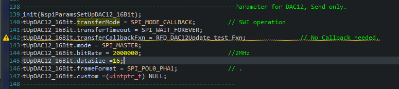

I have it working but keep crashing. I tried HWI/SWI disabled but does not fix this.I also get this warning, how to fix this?
Description Resource Path Location Type
#515-D a value of type "void (*)(void)" cannot be assigned to an entity of type "SPI_CallbackFxn" TM4C_SPI_Master.c /RFDDAQ-1J/070_SPIBus line 142 C/C++ Problem

  • I mean "crashes" where SPI stop working after few minutes.

     It is not clear to me what you meant that the SPI stops working after a while.  Did the SWI still get called after you think the SPI stops working? Try to place a breakpoint in your SPI function to see if it is getting called.
     I'm not a TI-RTOS expert but I don't think it is necessary to disable the SWI if you can setup the correct priority such that your RFD_DAC12Update_SWI_Fxn will not be preempted by other SWIs. Same can be done for the HWI.
     Looking at your code, it does not seem that you are using the TI-RTOS provides drivers for SPI but rather you are using the TivaWare drivers for SPI. Is this correct? From a high level I don't see an issue with your usage of the Swi_post() within the HWI ISR. Below is an example code of using the SWI which is similar to what you have.

     So the problem can be either SPI specific or related to how the SPI is used in the Ti-RTOS context which will need more investigation from your side. Do you have many other HWIs/SWIs going on? What if for debugging purpose, you disable/remove these non SPI SWIs? Will it make a difference?
