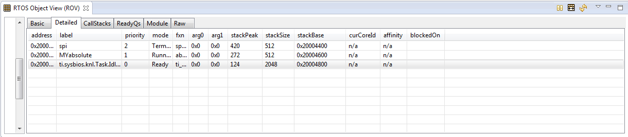

                 I am using all the SSI modules. SSI 0,2,3 works fine but SSI1 crashes at SPI_transfer(). After debugging i found the problem in following statement in SPITivaDMA.c file.
                         if (!Semaphore_pend(Semaphore_handle(&(object->transferComplete)),
                            object->transferTimeout))
               I have tried following solution from Forum
        1. Selecting right device in properties->general->device.   2. I have used ROV for stack level checking but all stacks seems ok.  3. I have increased stack size for HWI.
               But none of above works. I have attached snaps of ROV and SSI module configuration code.

  • Hi Digvijay,
    Can you elaborate on what you mean by crash? Do you get an exception, hang, or API failure.
    Todd
  • Respected sir,
    Thank you for the reply. The issue has been solved. The DMA channel for SSI1 were conflicting with DMA channel for SSI0. When i changed DMA channel problem got solved.
    Digvijay
  • Digvijay,
    I'm having similar trouble with using SSI1 and have found this post to be very helpful.  I can get SSI2 and SSI3 working just fine.  However, I'm having great difficulty with SSI1.  Would you mind posting your DMA configuration solution as a reference?  Did you have to change the DMA Channel Map Select and Index?  Are there other register setup requirements for SSI1 not necessarily needed for SSI3?  I've posted this question to the forum (link) and would greatly appreciate any help you could provide.  Thank you!
  • My trouble was also with the uDMA channel although I'm not clear why as I never defined the SSI0 as a conflicting code as you found in your own.   Please find the included code for future reference.  Does this look OK?  Feel free to suggest changes if you see something wrong.  Seems to work on the Launchpad board.
