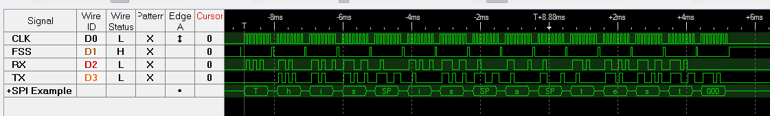

Hi i was tryin to configure hte SSI interface SSI0 as master and SSI2 as slave on the same controller and wrote a common firmware tot est the SPI by connecting the SSI pins to the respective complement pins of SSI2.I was able to read data wrote from master(SSI0) in the slave(SSI2) and tried to write the same data back to the master(SSI0) from salve(SSI2) .But this time when tried to read the data back the debugger stuck at the checking line for SSI busy. PLease help tpo sort out the issue. .

  • Each transfer on the SSI is both a transmit and receive for both the master and the slave. To make this work, first do a SSIDataPut() to the slave with some dummy data. Then when you do the SSIDataPut() to the master, the slave will respond because it is ready for the transfer. The transfers always start with the SSIDataPut() to the master. I will put together a sample routine based on your code in a little while.
  • I have attached an example project in a .zip file. Import this project into your code composer workspace by selecting "File" "Import" "Code Composer Studio -> CCS Projects",  "Select archive file". Since I am transferring an ASCII string, I used 8 bit instead of 16 bit transfers.
    /cfs-file/__key/communityserver-discussions-components-files/908/SSI0toSSI2.zip
    On an EK-TM4C1294XL evaluation kit, add jumper wires to connect:
    SSIxCLK PA2 to PD3
    SSIxFSS PA3 to PD2
    SSI0DAT0 PA4 to SSI2DAT1 PD0
    SSI0DAT1 PA5 to SSI2DAT0 PD1
    Here is what it looks like on a logic analyzer. RX is slave receive and master transmit. TX is slave transmit and master receive.
