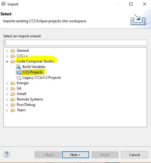

  • Charles,
    I though I would see of the problem remained in the file you sent but I have run into the problem that I can not get the project to load in CCS7.
    I unzipped the file to:
    C:\Users\Lee\Documents\Tiva\5381.enet_s2e\enet_s2e
    I opened CCS7 and tried to make a new workspace at the same location.
    I then had an empty workspace.
    I tried importing the CSS project and navigated to the same folder. The import dialog let me select the project.
    I then chose "Finish" for the import.
    I got the following error details:
    See details below.
    Invalid project description.
    C:\Users\Lee\Documents\Tiva\5381.enet_s2e\enet_s2e overlaps the workspace location: C:\Users\Lee\Documents\Tiva\5381.enet_s2e\enet_s2e
    I had to cancel the import to leave the dialog.
    Is there something about importing projects in a new workspace I am missing?

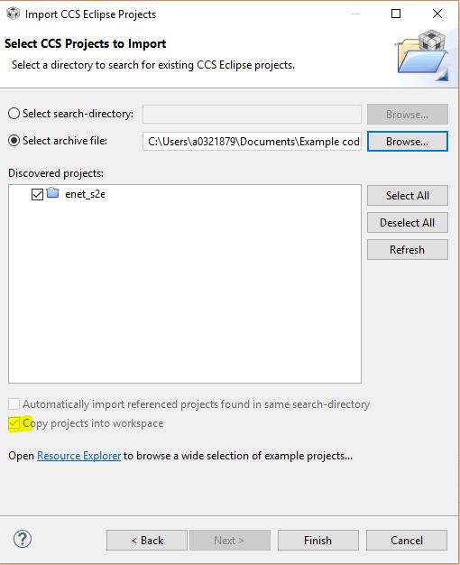

  • Hi Forrest,
     I'm not sure what is wrong with the import process. I created a new workspace and I can import it just fine using either CCS7 or CCS8. I have the "copy projects into workspace" checked. What if first unzip the zip file and import by "select search-directory"?
