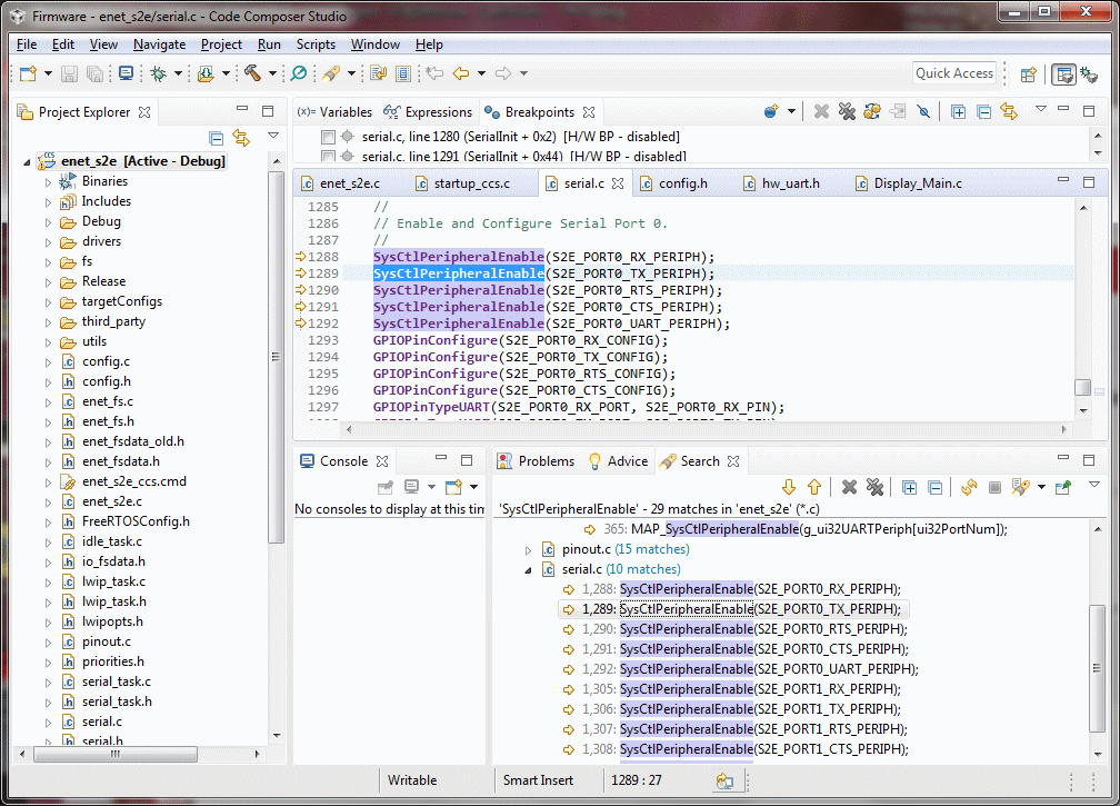

With the reference enet_s2e project I wired PC6 to PN4 and PC7 to PN5 to connect the UARTs. Then I used RealTerminal to send repeatedly a text file containing only ">04" into one telnet port. RealTerm allows me to set inter-character delays and delays at end of line and delays before the tile to be sent is sent.
I captured and time stamped the data out the other telnet port with a Processing program I wrote which time stamps to milliseconds (since program started) . I see the ">04" command is passed through the two telnet pipes in bursts. In the screen shot I will provide there is a burst where the delay was 217 milliseconds and three ">04" commands were sent. See time stamp 2019 3 14 17 12 187874.

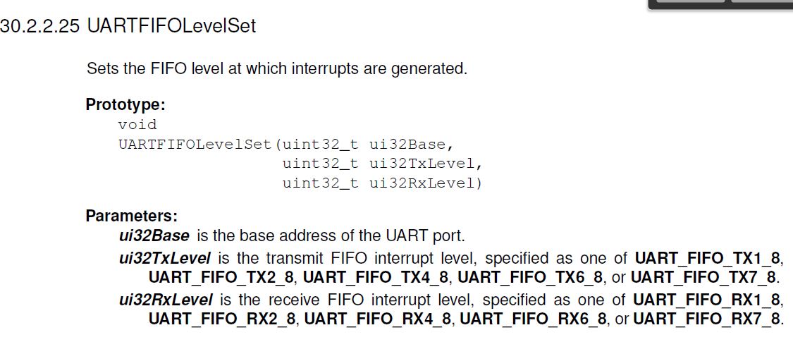

I have begun to examine the enet_s2e code and see what I think as a 40 mS HOST_TMR_INTERVAL managing the telnet UART buffers and so I would have thought that the burstyness would be on the order of 40 mS not 200 mS.
Any improved insight would be appreciated.
I would like to understand the code enough to possibly flush the buffer when a <CR> or <LF> occures for example but am not sure that might violate the design in ways I can not anticipate.
