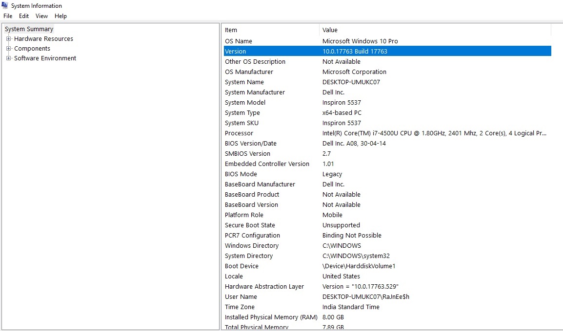

This is regarding the custom board having TM4C1294KCPDT on it. There is some issue with the USB COM Port drivers. Windows 10 detecting the COM as "USB Composite Device" and If i tried to update the drivers it shows error "The best drivers for your device are already installed".
Kindly suggest how to resolve this issue, so that I can have proper COM port in device manager.
Below are the screenshots for your reference:

    Below is the screenshot of different Windows 10 machine.
      Please see the below post and download the Windows 10 driver patch as suggest and see if it makes a difference.
    https://e2e.ti.com/support/microcontrollers/other/f/908/p/695953/2565196?tisearch=e2e-sitesearch&keymatch=usb%25252525252525252520patch#2565196
    Tried with the new patch files on above link as per the instruction mentioned in Readme file. But still same problem.

  • Hello Rajneesh,
    The usblib function which handles the creation of the composite descriptor had a logic flaw that causes the enumeration to fail on Windows 10 as it tries to enumerate Endpoint 1 twice.
    In order to resolve this, you will need to update your usblib with the fixed function that address that problem. Please follow the below steps.
    Replace your usbdcomp.c file with this attached file (make sure it is still named usbdcomp.c as E2E will usually add some extra characters to the file name):
