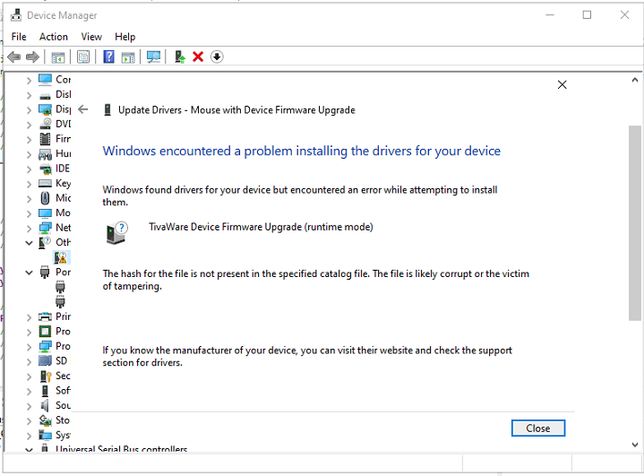

I have imported the USB boot loader example into CCS. I have modified the code so that instead of having a HID mouse and DFU it has an CDC and DFU. When I start the application windows finds the device. It automatically uses the driver for the CDC. I can then write to a terminal. So no issues with that. However the DFU comes up as other devices without a driver. I tried to install a driver by pointing the search to the drivers directory of the TIVA ware folder. But it doesn't install any driver. Anyone know what the issue could be? Thanks

  • Its trying to install the driver now with the example not modified. But there is an issue with the hash. If I resolve this then the example should work.
  • Hello Jon,
    Which version of TivaWare do you have and which drivers are you using from it?
  • Hi Ralph
    Its 2.2.0.295. I am just pointing the driver installer to the drivers dir of the TivaWare.
    Jon
  • Hi Jon,
    Okay, let me look into this on my end... this is a recent release so maybe there as an issue there.
    In the meantime, use the drivers from here and see if that fixes it: software-dl.ti.com/.../SW-TM4C-2.1.4.178.PATCH-1.0.zip
  • Hi Ralph
    Yes the drivers from that patch worked.
    Jon
