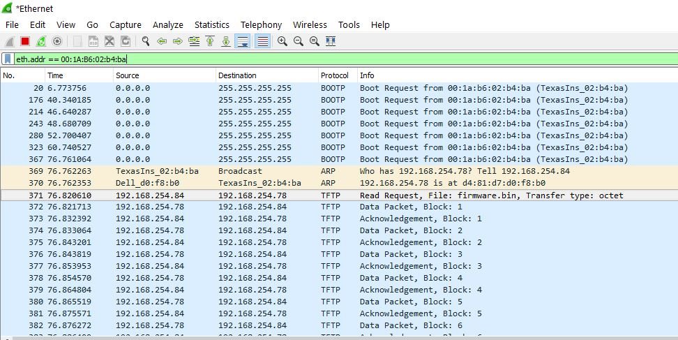

I am trying to get the LM Flash to work using the Ethernet. I am using the ROM boot loader and it works fine with a eval board. But I am trying to do the same thing at a customer site on their custom board. I can get so far into the process. The UDP magic packet is detected and the BOOTP packets are sent from the board, but it looks like something strange is happening with the TFTP packets. Below is the Wireshark from the board. The TFTP read request doesn't look right compared to what I get on the eval board (see below). For a start the dst address is 0.0.0.0 rather than the address of the pc. Also the TFTP request has a lot of parameters missing. The only thing I can see that is different is that I am not getting an ARP packet from the board. Would this cause the issue of is it something else?
  • Hi Jon,
      Below is what I capture running the ROM-based Ethernet bootloader. My board's IP is 192.168.254.84 and my PC's IP is 192.168.254.78. I do not see a problem.

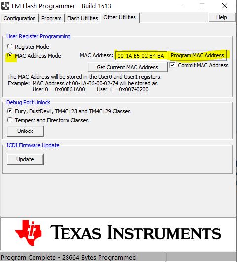

    In your capture, I do not see any ARP. The ARP is needed to resolve the PC's MAC address. Is it possible that you forget to update the board's IP and MAC addresses in the LM flash programmer when you use the custom board at your customer's site. Remember that both of them will be different compared to your LaunchPad when you were running it at your own office network. See below, I specify the IP address and the MAC address in the LM flash programmer. Your PC is not just a TFTP server but also a BOOTP server. However, unlike DHCP, the BootP is static and you need to associate the IP address with the MAC address manually. Therefore, I will suggest you check two things.
      1. Does your customer's board have a MAC programmed in the flash. I think this is an likely problem. Bear in mind that the LaunchPad is pre-programmed with the MAC address by the factory. The custom part will not be pre-programmed with the MAC address. Your customer will need to acquire the MAC address that is assigned to his company. You can program the custom MAC address using the LM flash programmer. You can use Uniflash to program the MAC address if your debug probe is XDS100 or XDS200.
    2. Next check if you have entered the correct IP and MAC addresses in the configuration tab.

      You might want to check the Boot Reply packet. The Boot Reply from the server is supposed to contain the server's IP address. Once the client obtains the server's address it can send the ARP to find out server's MAC address. Why is the laptop's MAC empty? Perhaps the client didn't get the IP address of the server or just as you stated the ARP didn't finish. In your wireshark capture, the ARP packet is not even shown.

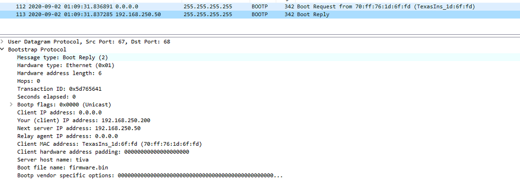

  • Hi Charles
    As shown below the BOOTP reply from the board seems fine. It has both IP addresses. But as you can also see below the TFTP has no MAC address for the dst in the TFTP packet. On my eval board capture there is the MAC of the pc there.
    Jon
  • Hi Jon,
      Earlier you said you programmed the MAC address and read it back fine. If this is the case, the client is supposed to put out the correct MAC address for the DST address.  I really don't know why a 0 address is put out. Please note that not only the MAC address is 0 but also the DST IP address. This is why I ask to check the Boot Reply. Expand the Boot Reply packet and find out what is in that reply packet.

  • Hi Charles
    The BOOTP reply from the board is shown in my prev message. You can see that the two IP addresses are OK. The TFTP read request from the board has the DST address as 0. I can only think that because the ARP messages are not being seen that the board never gets the MAC address of the pc. It then just uses 0 as the MAC address of the pc as it doesnt have any other address to use.
