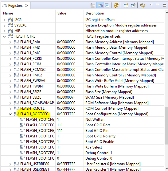

    How can we check the status of BOOTCFG register when connected with J-TAG in CCS?
    Vamai
  • Hi Bob,
    Thank you for the update.
    I have verified by making PB0 high and it is working.
    Is there any way to check BOOTCFG when target connected with J-TAG in CCS?
    Vamsi
  • It can be displayed in the register window as part of the FLASH_CTRL registers.
