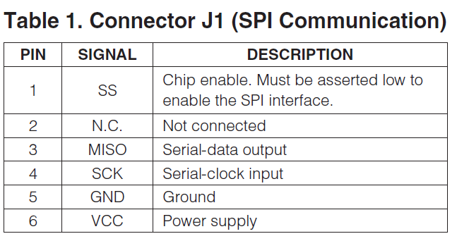

I have problem with reading temp from MAX31855MPB1 (Thermocouple). I'm using SPI communication and try to read from the MAX31855 using SSI0 port.
However, it not read any value from the MAX31855. I use debug to see if I get any data from the SPI but it stuck at
SSIDataGet(SSI0_BASE, &pui32DataRx[ui32Index]); // the code stop here and not go anywhere
Can some one help me with this. What do I need to change in my code to make it reading. Since this is the thermocouple. I only want to read value from the sensor. No Tx need for this.

  • Hello Chuong,
    Can you attach an scope to your SPI lines and see if the SPI clock is being generated? I have to say I never have seen a use case quite like this, so I am not positive if the SPI Clock would be generated without MOSI configured. In theory it should give what you are doing, but I want to be sure on that.
    I will also try and run the code myself when back in the office, but in the meantime if you can look into that, that will give some idea about what may be going on here.
  • Hello Chuong,
    Okay so you need to use SSIDataPut to trigger the clocks.
    Also since you need 32 clocks without SS disruption you need to use Advanced Mode.
    Add this to your SSI configuration before SSIEnable:
    	SSIAdvFrameHoldEnable(SSI0_BASE);
    	SSIAdvModeSet(SSI0_BASE, SSI_ADV_MODE_WRITE);
    And then use this code to generate the 32 clocks for the data to come in on:
    	SSIDataPut(SSI0_BASE, 0x00);
    	SSIAdvDataPutFrameEnd(SSI0_BASE, 0x00);
    You should then be able to read the 4 bytes with SSIDataGet.
    No need to configure MOSI for this still, the function doesn't need to output data over MOSI, it just will trigger the clocks the slave is looking for.
  • Hi Ralph,
    Thank you so much for the reply. I changed the code as you advised but no luck.
    I'm not sure where I did wrong. The MAX31855 have the data is output in a signed 14-bit, SPI-compatible. I'm not sure how to make this to signed value.
    I'm pretty new to Tiva C.

  • Hi Ralph,
    I changed the data bit from 16 to 8 bit and the code is just stop at SSIDataGet.
    Here is my wires config.
    LaunchPad ------------- MAX31855MPB1
    PA2 ------------------------- PIN 1     (SS)
    PA3 ------------------------- PIN 4     (SCK)
    PA5 ------------------------ PIN 3      (MISO)
    3.3v ----------------------- PIN 6       (VCC)
    GND ---------------------- PIN 5      (GND)

  • Hello Chuong,
    The code stopping there isn't too surprising if the Slave doesn't send data back. You need to scope the SPI lines. If the Clock is correctly generated, then there may be an issue with the slave device, the clock polarity, etc. - there is only so much I can guide from a TM4C standpoint on that front. But right now it's not clear if the Clocks are being generated right, so please confirm that you are able to observe what I am seeing on my end.

  • Hi Ralph,
    So if I want to read 32 bits but the FIFO only support 16 bits. How I can read 32 bits from the SPI?
    Chuong
  • p/s: I mean how to get 32 bits in on shot from SPI although the MAX31855 requires 14 clock cycles ("A complete serial-interface read of the cold-junction compensated thermocouple temperature requires 14 clock cycles")
  • Hello Chuong,
    Reading the D/S in detail you can basically read 14 or 32 bits - when I first looked I had thought it was 32 bits because of how the register for reading is structured.
    Drive CS low to output the first bit on the SO pin. A complete serial-interface read of the cold-junction compensated thermocouple temperature requires 14 clock cycles. Thirty-two clock cycles are required to read both the thermocouple and reference junction temperatures
    So if you want just the temperature then you should be able to get all 14 bits in one read command with the configuration shown. In this case, you don't ever need to worry about 8 bits or 32 bits.
    But if you need 32 bits, you may need to use advanced mode. The way provided code means that you would read 8 bits 4x, so you need to cycle through the SSIDataGet API four times. But that all only matters when you want all 32 bits.
  • Hi Ralph,
    Somehow when I use the Adv Mode, it stops right at the SSIDataGet function because the 8 bits reading. If I change to 9 or above then it will run for one time only and the rest is just 0.
    Do I need to enable the GPIO_PA4_SSI0XDAT0 for Tx? Do I need to Disable SSI after get data and enable fore the for DataPut?
    Also, while(SSIBusy(SSI0_BASE)){} is not working with the Adv Mode.
