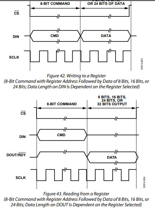

I'm not familiar with the AD71772-2 device. However, reading its datasheet, it supports continuous conversion mode, continuous read mode and single conversion mode. Which mode are you intending to operate? Below is a timing diagram for single conversion mode. Can you please show a logic analyzer capture output to see if it matches the single conversion mode?
Dear Charles,
Firstly, Thank you for your response. I've configured it in Continuous Conversion Mode(which happens to be the default mode).
Timing diagram available on pg: 37 of the data sheet.

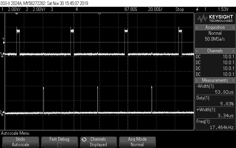

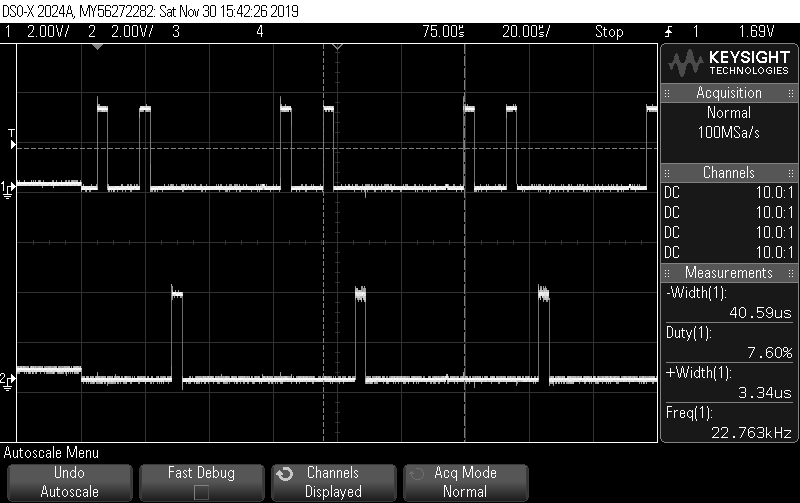

I'm attaching the scope shots from my DSO.
Image - 1 (CH-1 : DIN, CH-2 : DOUT)
Image - 2 (CH-1 : DOUT, CH-2 : FSS)
Please suggest me what do I do next. I had been struck here for quite a while now. The source code is in my previous reply on this post. How to read 32-bit value instead of 8/16 bit value.? (As of now I'm reading 8-bit when I'm configuring SPI in 8-bit mode and 16-bit when I'm configuring it in 16-bit mode) Any lead is highly appreciated.

Can you not capture your waveform with all four signals (CS, SCLK, DIN, DOUT/RDY) all probed on the same screen? It is really hard to see your signals in relation to each other, especially with the the presence of the SCLK. If you are operating in the continuous conversion mode then you need to reference the below diagram. Please note I'm not familiar with this third party's ADC. I'm reading its datasheet just like you.
After you write the command (0x44) you should wait for the DOUT/RDY to go low. You can use an interrupt on falling edge of RDY. Once the processor is interrupted you can read the data. The datasheet shows that the CS remains active low. In your capture, I can't really make out what happened to the CS. It looks like it is going high every 8-bit word. Why don't you try to tie the CS low and see what happens?

Why are you using advance mode? See below. Advance mode can only operate with SPO=0 and SPH=0. Your code configures for the SPI_MODE_3. Use the MODE_0 instead in legacy mode instead.

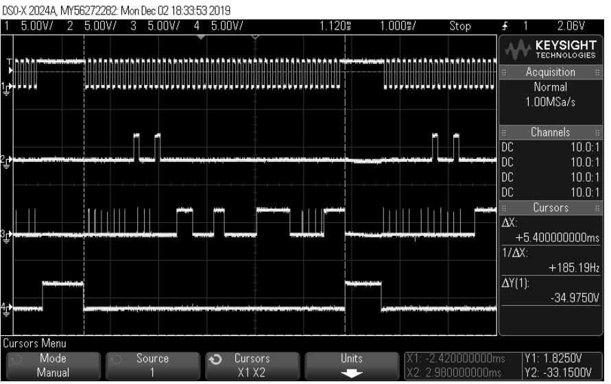

I'm attaching the screenshot of all 4 pins. As per Analog Devices, 32 clock pulses should be sent after 0x44 is written to DIN and I manually counted and there are eactly 32 pulses, which means as per the data sheet it has to give a 32 bit value.

1. I thought you were going to change to a 8-bit command. However, from you capture, you are giving three 16-bit back-to-back commands. Are you sure you can give 16-bit command? Please consult with your ADC device vendor. Show them your capture and they should be able to comment if 16-bit command is valid. From my interpretation of their datasheet, you need to give an 8-bit command.
2. From the capture, there are a few glitches on the DOUT line even before the the 0x44 is sent on the DIN. Why are these glitches? I'm just as curious as you are. You ADC vendor can help on this question.
3. I see in your ISR, you call the UARTprintf(). I think you should comment it out during your experiment. Calling UARTprintf() in an ISR is never good. The UARTprintf() can take many cycles to complete because the UART baudrate is much slower than the SSI ISR. You can miss an intended interrupt which are to occur in the future if you stay in the ISR too long. The ISR normally should be kept as short and quick as possible. When you are in the ISR, you can set a global flag and then exit the ISR. In your main() you can wait for the flag to set and then process the data. If you don't want to do it this way, you should at least comment out the UARTprintf() first.
4. Perhaps you have updated your code. In your original pasted code, you only have two SSIDataPut(). If you are going to read three 8-bit data then you need to have a total of 4 SSIDataPut() in your ISR, isn't? The first one would be to write command 0x44 and another three dummy writes to provide SCLK to the ADC device to read the data.
5. Why don't you start with just 'one' single conversion instead of continuous conversion. If you can get just one conversion to work, I think it will be easier to expand onto other operating modes.

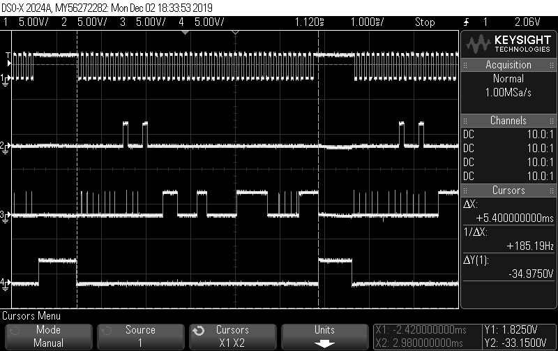

Screenshot : CS, DIN, DOUT, SCLK with i/p voltage = 0V. Vref = 2.5V
Observations are as follows:
Input Voltage = 2.5V , Output = 2^24
Input voltage = 0V , Output = 8424045 (2^23)
Input Voltage = -2.5 , Output = 32,000 (2^15)
All other configurations used are default configurations.

Pranav Deep said:1) False interrupts i.e., interrupts due to noise fluctuations ( How do I eliminate them?)
We have successfully resolved 'hundreds' of such noise issues - these points may prove helpful:

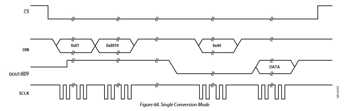

It is always useful to, 'Overlap the Scope Cap' w/the device's timing chart. (at least to present each - as similarly as possible.) That said:
The ADC's timing chart (Single Conversion):
and now (Continuous Conversion)
Note the duplication (in signal placement) between the modes.
And then poster's scope cap - strangely, 'Deviates from that signal placement - while being 'unlabeled.' Yet earlier - this poster was 'praised' for the clear thought & effort - revealed w/in his opening post!

Your scope capture looks much cleaner now. As far as why you are receiving 0, I think it has to do with the advance mode you use. Did you have a chance to read my reply on Dec 1, 2019 4:44 PM? I mentioned that the advance mode only works with MODE_0 which is SPO=0 and SPH=0. You are configuring the SSI in MODE_3. Can you use the legacy mode instead? If you need to hold the chip-select active the entire transfer you can either use a GPIO pin and drive low as a chip-select or you can use the frame hold by calling SSIAdvFrameHoldEnable().

follows a true copy from poster's ADC manual:

There are two separate notes in the datasheet stating that only MODE_0 can be used with the Advance mode using the SSiAdvModeSet().
This is why I suggested the poster to use the regular legacy mode instead. In legacy mode, he can use the MODE_3.
Note: SPO = 0 and SPH =0 is the only frame structure allowed for Advanced, Bi- and Quad-mode.

In the poster's reply on Wed, Dec 4 2019 6:06 AM, he has the following capture. He is not writing 0x44 which is supposed to be the command to read the data register. He is writing 0x0044 instead. This is why I questioned him about using the 16-bit mode. I'm not sure how the ADC behaves with 0x0044. That will be a question for ADI to confirm. it may be ok as the ADC may just ignore the first 0x00 and only recognizes the next 0x44 as a write command. Regardless on the command size, he is not reading any data when we can see clearly some data appears on the DOUT signal. This is why I question about the Advance mode.

This weekend we requested his, 'Scope cap under these (above/successful - 16 bit) conditions. No such (past, succeeding) screen cap was presented.
He obtained those correct 16 bit results someway - somehow - young staff simply (and quite properly) requested the 'HOW?'

We do agree w/you that it is, has been & remains 'unclear' if the ADC will accept an '8 bit value' via a 16 bit SPI frame. Yet another 'Fly in the ointment' is the ADC's requirement to:
Note that - as 'certain' ADC Commands return 16 bit Data - the, 'Reliance upon only (multiple, cascaded) 8 bit SPI Data may not succeed.' (At this stage - we do NOT know...)

Note this (Pg 20, ADC's manual - a 'true copy'):
Now all here (poster, vendor's Charles & cb1 team) have sought to, 'Exploit the (many) advantages afforded by the MCU's 'SPI Module.' (i.e. the relative 'ease, speed & accuracy' by which SPI Data is both 'Sent & Received.')
However - except for the (limited) case of:
and
it is believed that the 'Switch between MCUs 8 bit & 16 bit frames (and/or) a 'massaged' 24 bit one' - may not prove 'easy & glitch-free.'
