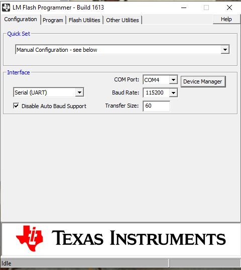

    Open LM Flash Programmer. Set it to manual configuration, Serial (UART), and 115200 baud. Set the COM Port to the "Stellaris Virtual Serial Port" number found in your device manager. You can use the "Device Manager" button on LM Flash Programmer to open the Device Manager. It should look like this:

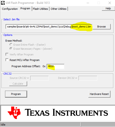

    Now on the program tab, browse to the boot_demo1.bin file. (C:\ti\TivaWare_C_Series-2.1.4.178\examples\boards\ek-tm4c1294xl\boot_demo1\ccs\Debug\boot_demo1.bin) Set the program address offset to 4000.
    Press the reset button on the board again. You will now see LED D1 blink. You have successfully used a flash bootloader to load new code into the device.
