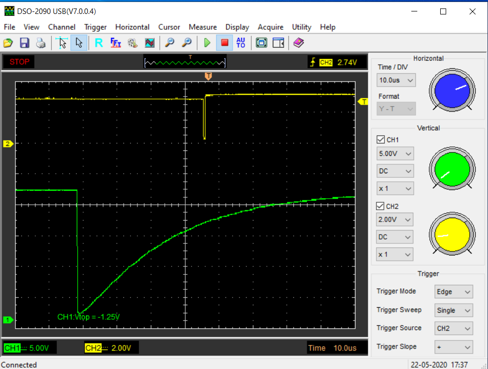

I had a bootloader which maintains PL3 at high and should remain at high after it has handled a firmware update and jumping to the newly flashed application.
There is a small spike spotted at PL3 which is causing problems for my output buffer chip.
Hoping to have any pointers for how to make this small spike disappear ?
Attached scope capture. Wave 2 is the output signal from Tiva's PL3.
regards, GH
  • It depends on how your bootloader jumps to the application code. What is channel 1?
    If you are generating a reset to jump from the bootloader to the application, you can add a pullup resistor externally to maintain a high level.
