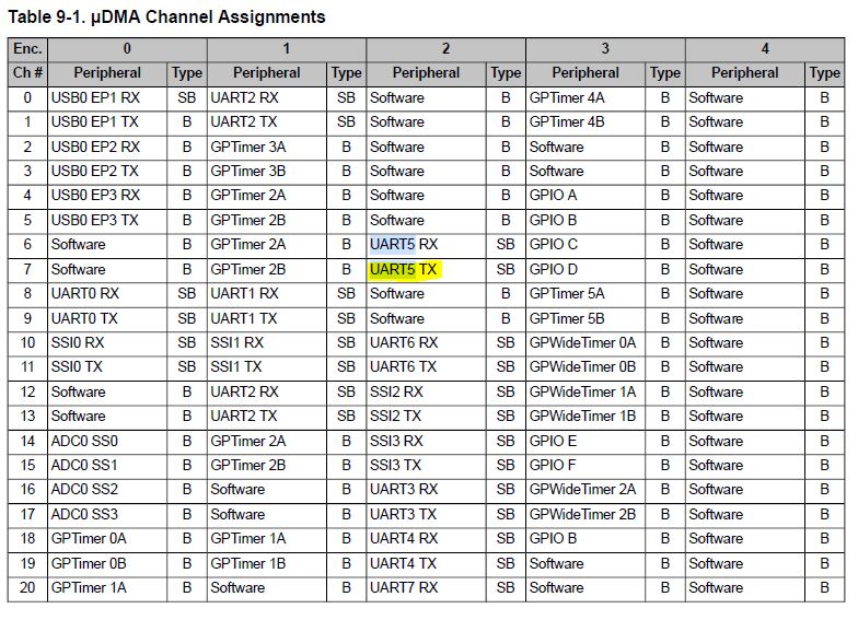

Hi All,
uDAM writes buffer to UART
Section 9.3 to 9.3.2.3 of Tiva TM4C123GH6PM Microcontroller, SPMS376E.
I followed the instructions and I was able to transfer words from buffer to buffer as well as bytes buffer to buffer.
Section 9.3.3 to 9.3.3.3 Configuring a Peripheral for Simple Transmit.
I followed the instructions, but the UART didn't receive data from DMA; because
when I write characters to the UART's buffer, it sends them to Putty terminal.
am I missing some instructions.
Here is a snip of instructions related to the initialization and transfer
#define CH7 (7*4)
#define BIT7 0x00000010
#define SIZE 64
uint8_t SrcBuf[SIZE];
uint32_t ucControlTable[256] __attribute__ ((aligned(1024)));
//*********************** added to select a peripheral *******************
UDMA_REQMASKCLR_R = BIT7;
// Select peripheral for channel 7
UDMA_CHMAP0_R = 0x20000000; // UART5_TX
UDMA_USEBURSTSET_R= BIT7; //µDMA channel [n] responds only to burst requests.
//******************* Modified to trasnfer from buffer to peripheral ******
ucControlTable[CH7] = (uint32_t)source+63; // last address
//2. Program the destination end pointer at offset 0x074 to the address of the peripheral's transmit
//FIFO register (UART5_DR_R).
ucControlTable[CH7+1] = (uint32_t)UART5_DR_R; // last address
ucControlTable[CH7+2] = 0xC0008001+((count-1)<<4); //DMA Channel Control (DMACHCTL)
//Start transfer
UDMA_ENASET_R = BIT7; // µDMA Channel 7 is enabled.
UART5_DMACTL_R =UART_DMACTL_TXDMAE ;// µDMA for the transmit FIFO is enabled
UART5_DMACTL_R |=(1u<<1); // Transmit DMA Enable
//**************************UART registers related to DMA ******************
UART5_LCRH_R= 0x00000070;// SPS:WLEN[2]:FEN
UART5_CC_R=0x0 ;//System clock (based on clock source and divisor factor)=80Mhz
UART5_CTL_R|=(1u<< 8)|(1u <<0)|(1u<<4); //UARTEN=1, FIFO enable
UART5_ICR_R =0xFFFFFFFF; // clear all int
UART5_IFLS_R |=0x00000003; // 4bytes or less generate event

  • What does the DMAWAITSTAT register show? This register indicates if the uDMA is waiting for a request from the peripheral. As I mentioned in my last reply we do not support DRM. I will suggest you try the TivaWare example first. After the uDMA and UART are initialized, look at the register settings in these two modules in the CCS (or your choice of the debugger) register browser window. Next, bring up your own DRM program and also look at the register settings in those two modules. You can then compare the register settings between the TivaWare example and yours and find out if there is any mis-configuration.
    You can also modify the TivaWare uDMA example to transfer to UART5 instead of UART1. It should work for all UARTs that are listed in the datasheet including UART5.
  • UDMA_WAITSTAT_R. The bit that's corresponding to the channel is set. The corresponding channel is waiting on a request.
    Either the UART doesn't raise request or the uDMA doesn't response.
  • Then you need to find out why the UART side is not sending the request. As I said, use the TivaWare to get the register configuration and compare with yours.
  • FYI,  when I activate a clock to a peripheral, I wait for the bit to be set. I follow the protocol of setting.
