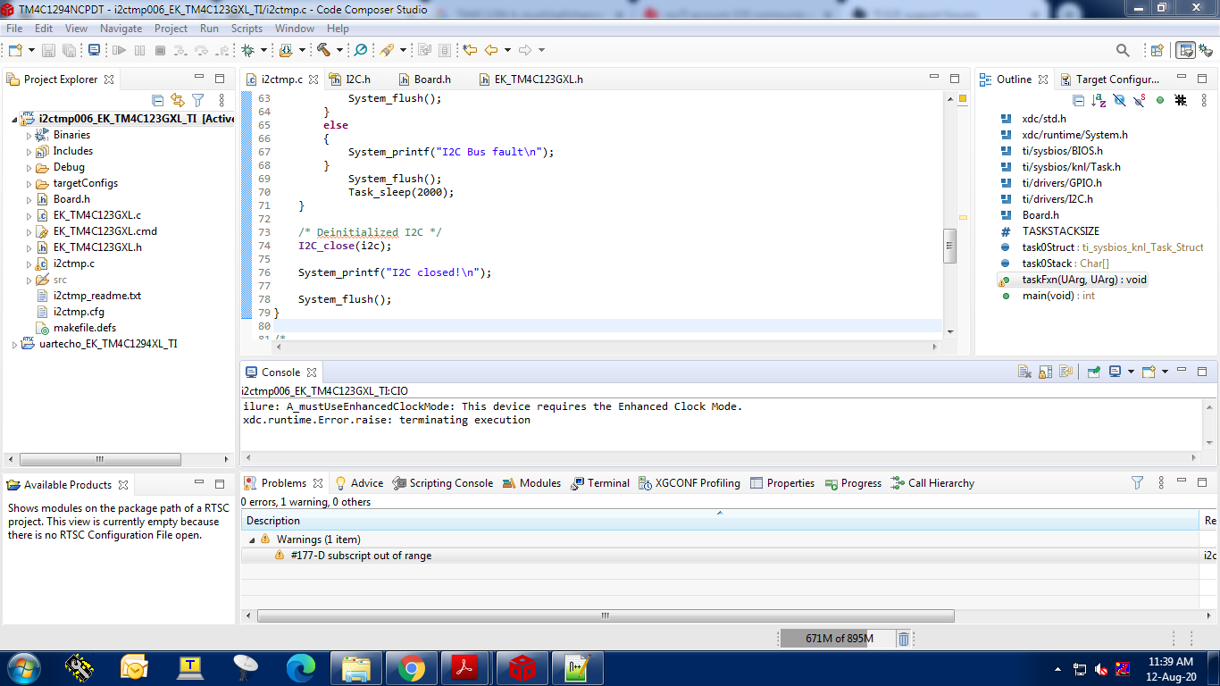

Hi
I'm using EK - TM4C1294XL with SI7021 temperature sensor and trying to get temperature but I'm getting the following error in the console. Here are the screenshots of the error also I'm attaching program below.
Program - >

Hi Omkar,
Can you attach the .cfg file? Also, what version of TI-RTOS for TivaC are you using?
Todd
Try adding the following lines to your .cfg file:
var Boot = xdc.useModule(ti.catalog.arm.cortexm4.tiva.ce.Boot)
Boot.enhancedClockMode = true;
Judah
Hi
Thank you, sir, for the reply I tried what you said and now there is no error thank you so much sir.
