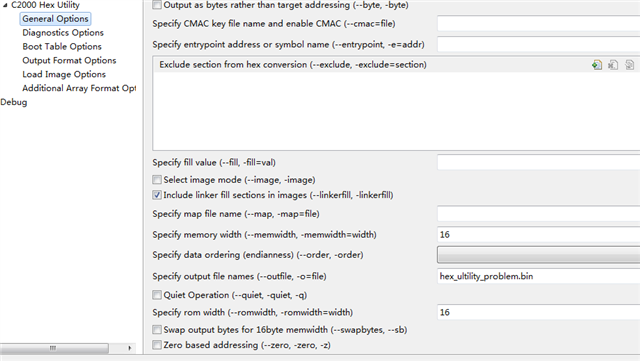

My customer use Hex utility to generate bin file, and found that there is no hole generated as below showed.
if they use post build option which is another way, there is able to generate the hole.
below is the configuration when use Hex utility configuration, any wrong for the configuration?
To have the hex utility generate a file that matches how memory looks, including any holes, you have to use image mode. Please read this forum thread for all the details.
