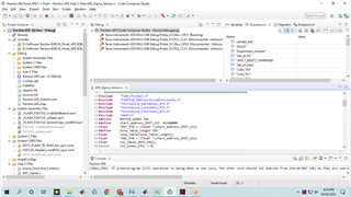

3. I could step through the code because the ITRAP occurs just after I dump the code to flash. I did try to step through but the cursor stays in the break point untill resume the excution.
Screen Shot:
4. The ACC value is 0x0000. I could not guess whether I am reading it correct or not. Also, saw the stack space in memory browser, the complete stack is empty.
Suggestions awaited.

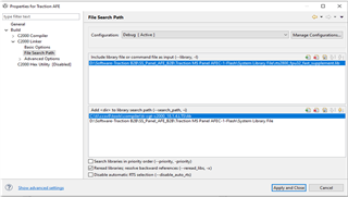

Hi Nikhil,
Do you gave the libc.a or the compiler rts library included in your linker options?
Veena
Hie Vamsi,
I have included the rts library. Please check the screenshot below:
Regards.
Vamsi,
I have tried by including libc.a in the include options and then added code_start as entry point. I got this warning which seems ok.
"warning #10063-D: entry-point symbol other than "_c_int00" specified: "code_start""
Now, I am not getting the ITRAP warning message. However, now I could debug the system using the watch window. The screen shot of the window after dumping code is below:
From above screenshot, it shows that the CPU is running. However, is not connected for debug.

Hie Vamsi,
As you can see in the earlier screenshot, the debugger is getting disconnected immediately after dumping the code to flash.
I am unable to control the code executing if I include to code_start as entry point, as said earlier.
Hi Nikhil,
In the snapshot that you provided, debugger is not disconnected. It is connected and the core is running. Try halting the core and load symbols as shown in step 5 of SPRAAU8A:
Thanks and regards,
Vamsi
