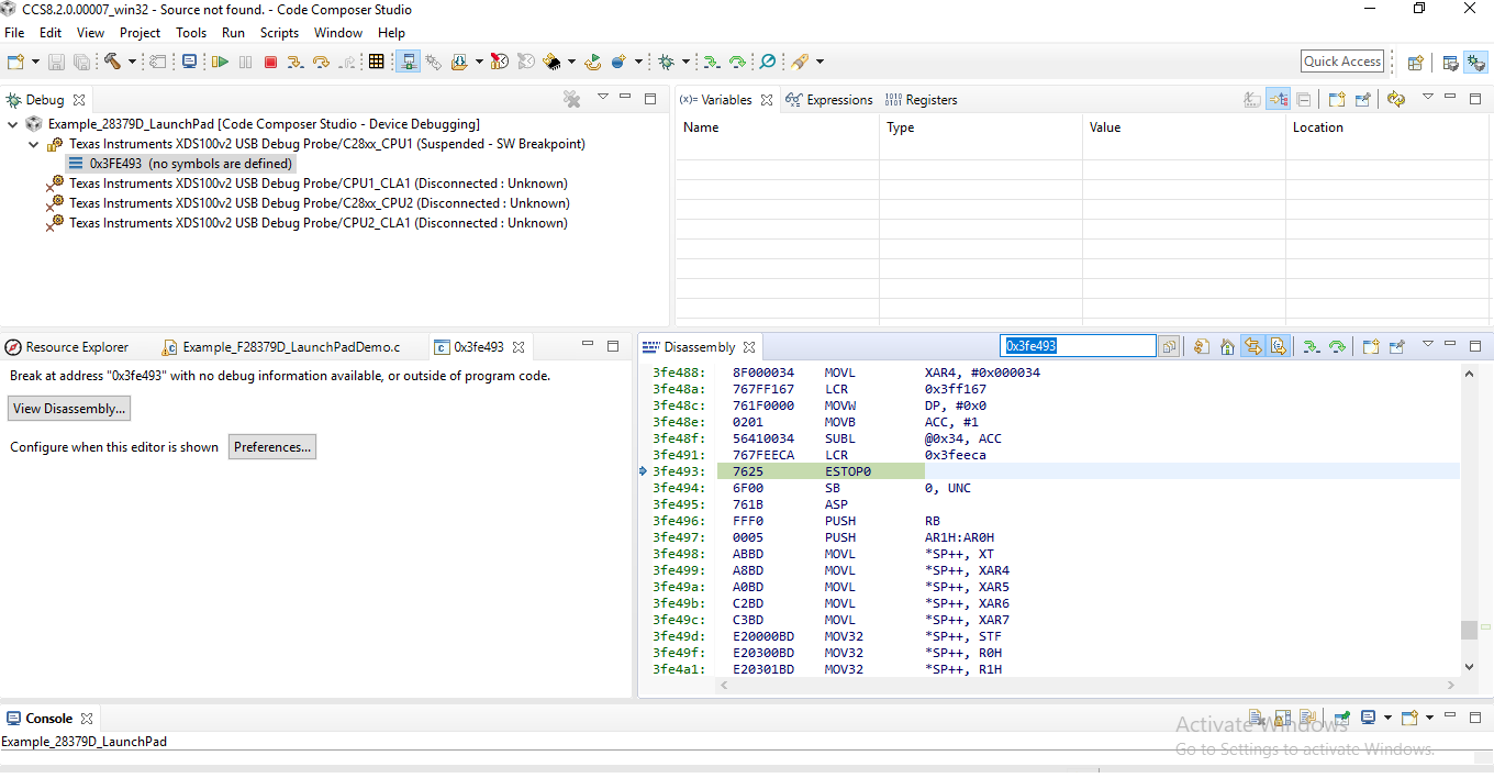

CCS/TMS320F28379D: Break at address "0x3fe493" with no debug information available, or outside of program code.
Part Number: TMS320F28379D
I am trying to load Launchpad demo application, but i get the above error. I am using only CPU1,
  • Naveen,
    Address 0x3FE493 is from BOOTROM. This address corresponds to c1brom_itrap_isr() function which tells me that CPU has executed Illegal intruction which has triggerred illegal interrupt (c1brom_itrap_isr).
    I would encourage you to use BOOTROM project available in below C2000Ware path. You can load the symbols and check it out yourselves.
    <C2000Ware>\libraries\boot_rom\f2837xd\revB\rom_sources\F2837x_bootROM
    I assume CPU started executing immediately after your application code got programmed.
    Manoj
